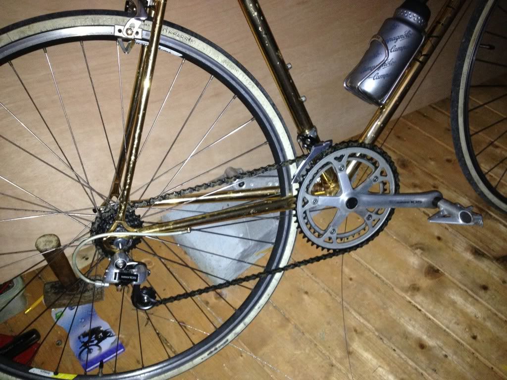

Here are my pedals (from a 87 raleigh) :
And i have (new) shimano spd-sl shoes and cleats. Are these compatible, is there something missing off the pedals?

You need Shimano PD64 cleats and also the correct toe clips
Below are Dura Ace pedals and clips but very similar to your needs

Cool thanks i'll have a look, are they available new?

Very difficult to find these cleats now, they occasional set pop up on ebay but they are usually expensive as the track cyclists use them and splash the cash when they are for sale

A Raleigh Century.....yum!
I'd be tempted to keep the original pedals on or buy these shimano style pedals!
Finding the correct toe clips and cleats will cost you a bomb - at least £50, where as these won't.............
http://www.ebay.co.uk/itm/RACE-ROAD-BIK ... 2c6787e9f9
or..............
http://www.ebay.co.uk/itm/Shimano-Vinta ... 43bdb8b91d

I've used a set of those cheap toe-clips (albeit in shiny chrome) and they work ok without cleats.

Sorry i meant to say, the pedals work with the 3-bolt tri pattern toe clips & straps, with modern shimano SPD-SL v-shaped cleats. They clip in fairly tight, and are quite easy to remove the foot. I dont think i'd dare use the proper cleats for these pedals with toe-clips (very dangerous!)
