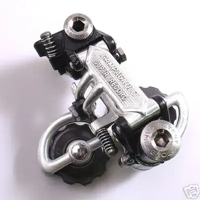

Does your Super Record mech look like this?
If so then I second the "sell it on" bit of advise because this is the first generation Super Record and they are quite valuable ($150 to $200 on the Bay)

Nope. Its the black one above with details different. What's bugging me is that the Nuovo Record I have works fine in that set up but the SR is nicer on the bike.
