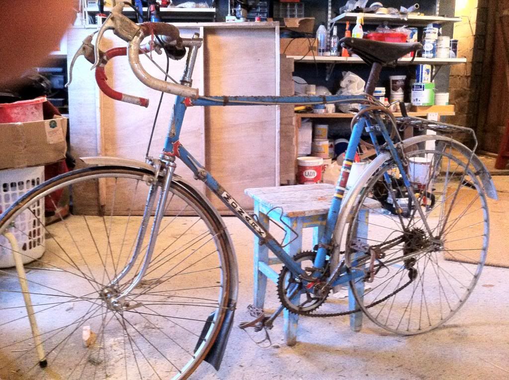

Got this bike today from a friend. He rode it a lot back in the day. It belonged to the Norwegian champion sometime during the early 70´s or late 60´s.
However, I intend to fix it up and use it for training and fun. Tips on restoring it and where to get parts would be much appreciated. At least I think I´ll need tyres, brake wires and tubing, handlebar "tape", a rivet for the seat (Brooks B17), brake pads an perhaps a chain (very stiff). Also, the rear wheel won´t follow properly when I hold the bike and pedal it. The gear shifter arm also "follows" forward as the chain moves. Pedals/chain get kind of stuck to before the "continue".
Well, here it is!

The drive-train issues may well just be caused by the chain being tight - I'd try splitting it and soaking it in oil myself as replacing it on its own is unlikely to be practical (you will more than likely need new chainrings, a new freewheel (won't be a cassette at that age) and maybe rear mech.
If the freewheel is sticking (not free-wheeling or slipping) lubricating that might help.
Cable inners and outers are fairly universal as far as I'm aware so, assuming you can get white, replacing those should be trivial.
Bar tape should be obtainable from a LBS but if you want to stay period you might struggle.
As for the (what look like) rust spots on the chrome bits - brillo pads and elbow grease followed by a light coating of wax should sort that out :)
Can't wait to see the finished article!

Looking at the parts this is a very old bike, maybe middle 1950s. From what I can see you have Universal brakes/levers, a Stronglight crank, and Campagnolo Gran Sport front derailleur/shifters/hubs. All of this is good because it points to a quality build that should be good to restore. I agree with the above comment that removing the chain and soaking it in a solvent is the first step. I would however not use the Brillo Pad because the steel wool in the pad is too harsh for chrome parts and can actually cause damage. Better to find some 0000 steel wool and use a light machine oil.
