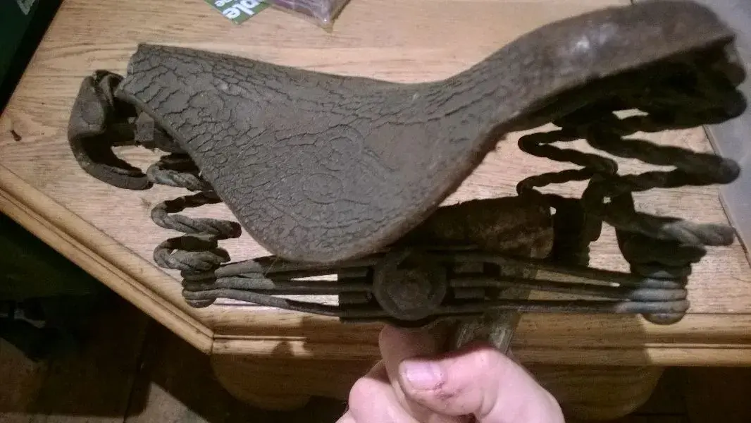

Think this ones shot :)

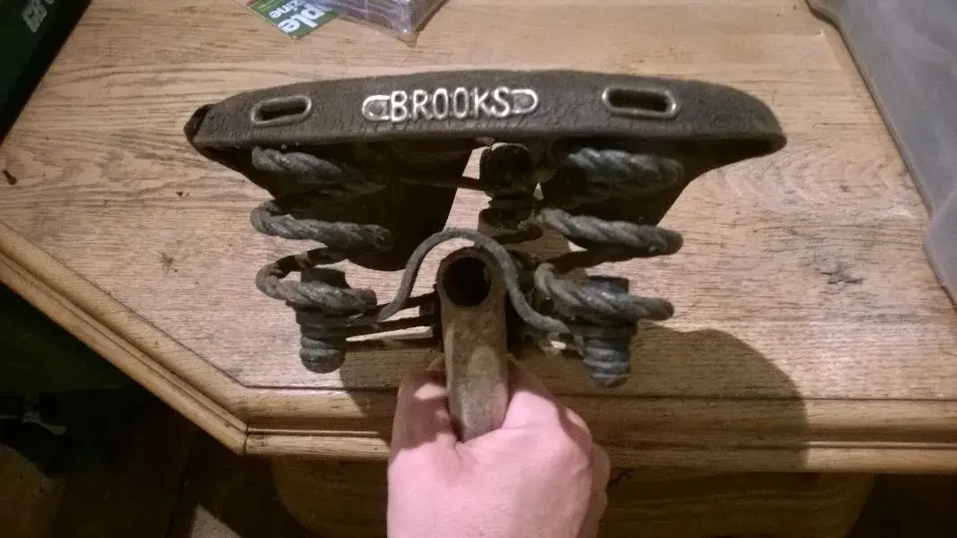

Posts: 641
Love the early Brooks badge.

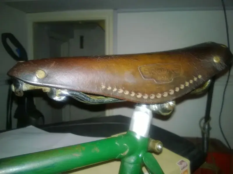

Gave this B5N a good soaking in soapy water and used dubbing on it. 3 coats of dubbing, all over, as it was really dry and had paint on it. Let the dubbing soak in and buffed it with a shoe brush. Then Cherry Blossom dark tan and polished it. Great thread Jonny!!
