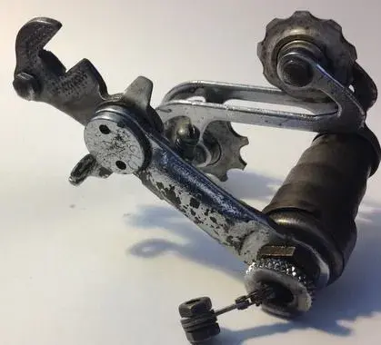

Hi to all,
My Campag Gran sport for my build has arrived. Without a hanger .Or Nut.
Is this because there never was a hanger nut as hanger would be threaded? The bolt does seem short.
Where on this good earth would i find a hanger?????????? Does anybody have one?
I really would like to use it as i was relatively cheap(although looks later) and apparently will be more reliable that Benelux Mk7
I fall on bendeded knee..........

The bolt doesn't need a nut. Either:
1) your frame has a built-in threaded hanger, in which case just screw the bolt in, or
2) your frame doesn't have an integral hanger, in which case you will need to source a separate hanger.
A photo of the rear dropout of your frame will allow us to clear up which it is.

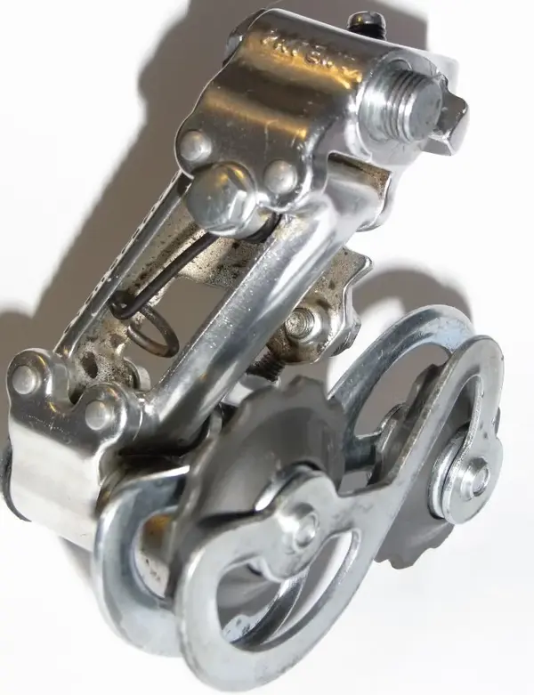

Benelux has integral hanger which is, as I have discovered on taking it apart, not transferable. :facepalm:
