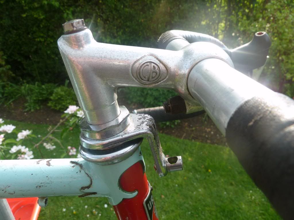

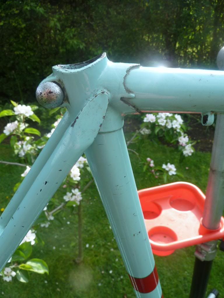

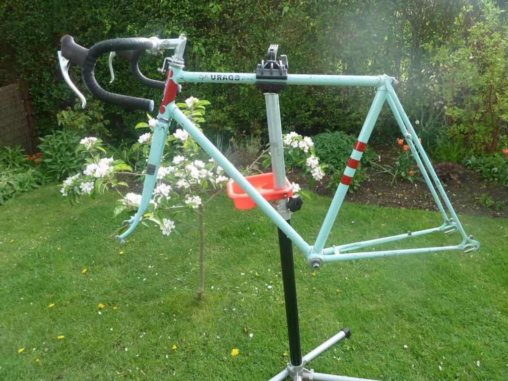

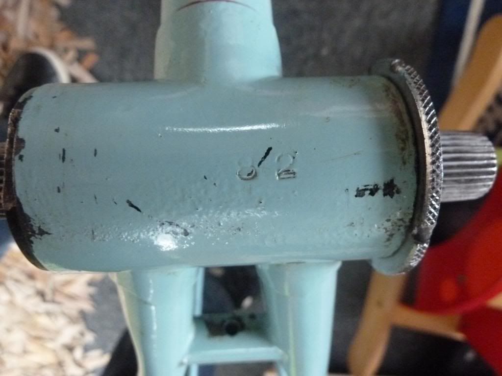

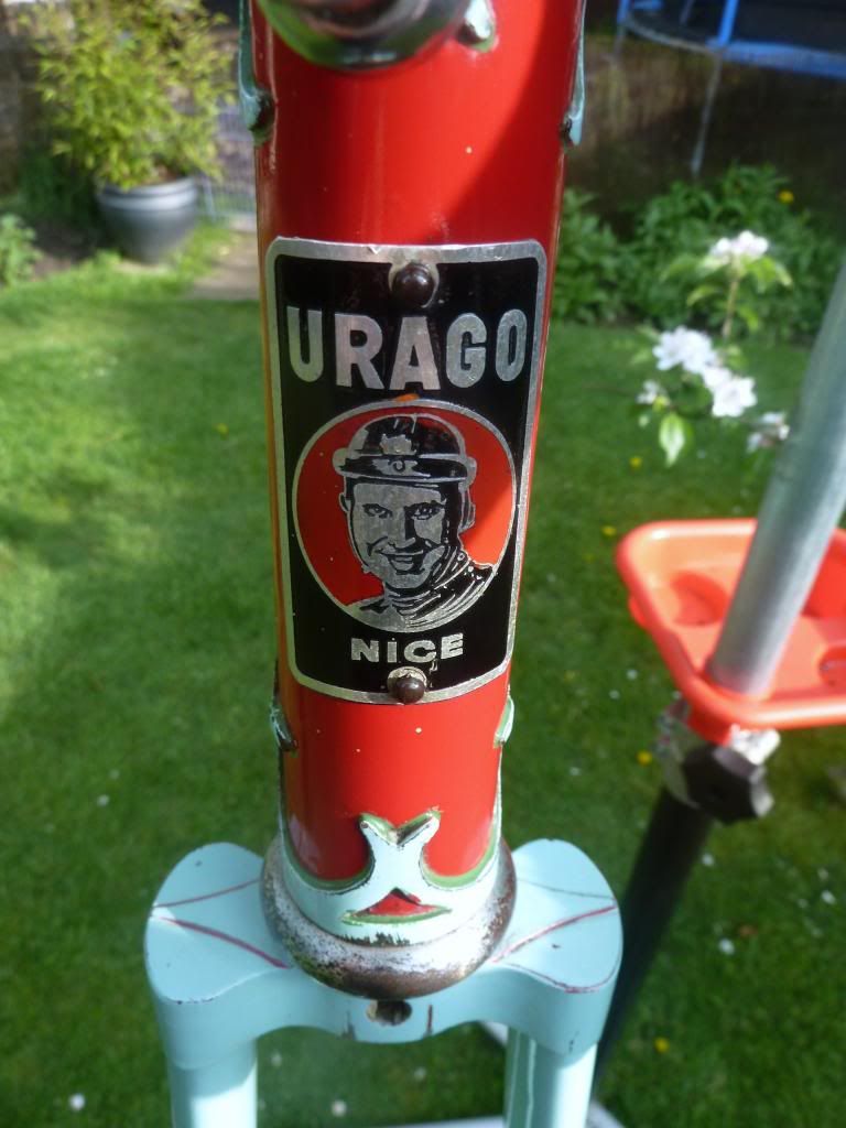

Can anybody help with the age of my Urago frame?
It does have 82 stamped under the bottom bracket, does this mean 1982?
It has Brev Campagnolo dropouts, i think its got a Gnutti bottom bracket and GB 70 stem.
Any help would be fantastic
Neil

Lugs, fork rake, braze-ons for 5 speed with cable split, no oil port on the BB, head badge puts it in the 60's era maybe a bit before, maybe a bit after.
Shaun
PostPosted: Thu May 16, 2013 10:33 pm
Joined: Sun Aug 22, 2010 7:07 pm
Posts: 1446
Location: Cotswolds
Shaun got there first, agree completely, the Gnutti cotterless was dead by late 50's. A P C (Johnny) Bowles imported Uragos about that time, and I had 50 Gnutti cotterless from him for very little.

PostPosted: Fri May 17, 2013 9:55 am
Joined: Sun Aug 19, 2012 11:43 am
Posts: 647
Location: Melton Mowbray
Chaps do you have any idea what the 82 stamp means?
Neil
