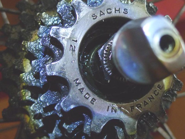

I though the cassette should probably the easiest part. I tried to remove it, but there must be a special tool needed, not same one as for say a 10-speed cassette. The old cassette is made by Sachs, but I need a new one. Which one should I get? Photo of the cassette below:
I would like to remove the cassette, replace it and possibly replace / adjust the bearings. There is a good bit of play on the bearings and the grease is coming out of the axle. The bike was badly maintained.

Looks like you'll need two chainwhips. One round the smallest gear, one round any of the others, and unscrew the smallest gear like you would the lockring.
EDIT: that is, assuming it's a cassette and not a freewheel.

That's a freewheel, not a cassette... you need the right tool (I can't remember which one it is right now). If you have a friendly LBS then they should have the correct tool. crank caps, jockey wheels, headset berarings... all could be found at a decent LBS, or online, or here on RB :)
Thank you. Can I replace this free wheel sprockets with an 8-speed Shimano cassette and if so, which one? I will pop in to my LBS on Saturday, see if they can help ;).

You'll have to replace the whole unit, the biggest you can go (sensibly) on a freewheel is a 7 speed, but there aren't many high end 7 speed freewheels about.

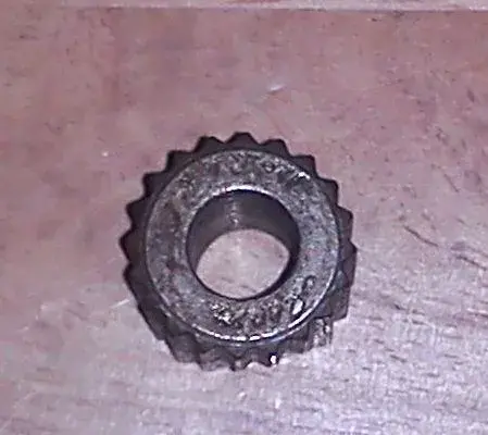

You will need a remover like this to get that off your old LBS might still have one :wink:

You can't replace it with a cassette, only with another freewheel. Cassette and freewheel hubs are completely different: http://sheldonbrown.com/freewheels.html
If you want to use a cassette, you'll have to change the whole hub. If you want to use the same hub, you'll need another freewheel (unless you can use the one you already have)

Sometimes the freewheel can be a right pain to remove, ask your local LBS to remove it for you, mine does it for free
