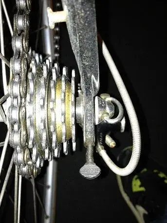

Hello - looking for some help with the 6 speed Regina freewheel on my Raleigh. It has been taken apart and re-tightened but the 3rd sprocket is moving off centre after a few rides and getting closer to the 4th sprocket causing the chain to jump - just looking for reasons why it is moving off centre - any ideas appreciated thanks.

Have you refitted the correct spacer?

Well it was taken apart by the guy who built the bike up initially and then when the problem occurred it was taken to a lbs who unscrewed the cogs and re-tightened and told me it looked complete and again was good for a couple rides but the cog has now shifted over again...maybe I need to split it up an take a pic...see if any of you guys can help..

That's a bit odd, it's impossible to crush a spacer so something is missing / back to front / ......

Very odd indeed - like i said it is fine at first with the freewheel sprockets all tightened up and perfectly aligned then that 3rd sprocket slowly starts shifting towards the 4th sprocket. I thought the first 2 smaller sprockets are screw on and the rest are splined ,so no idea how any of them could move once tightened..
