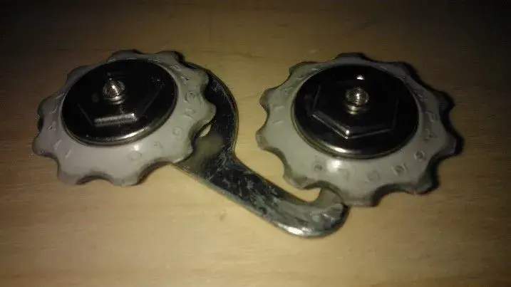

I have just finished restroing a C-Record rear mech and I want to try and bring a fairly decent set of jockey wheels back to life. I have cleaned all the loose dirt from them but cant get the last bits of discolouration from the plastic, i'm sure you know what i mean. Does anybody know of anything that will strip this off the plastic and bring them back to grey?
Many thanks for any help....
Stephen

The problem is the surface is scratched and oil has got into the scratches, I wonder if a weak solution of bleach would help

I tried a very strong solution of bleach......no effect

The only other thing I can think of is some 400 grade wet & dry then 800 grade then 1200 grade and remove the top surface, then some cutting compound (T-Cut, Farecla or similar) to restore a polished smooth finish to them

This clip gives an idea of how to restore headlamp lenses, and it is the same sort of idea for your jockey wheels

Might be worth experimenting with oxalic acid although you'd need a spare wheel to try it on first.
