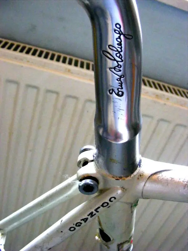

Pictures are from my 80s super, note seat stay with pantho and chromed chain stay with cable stop on bottom.

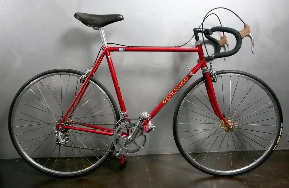

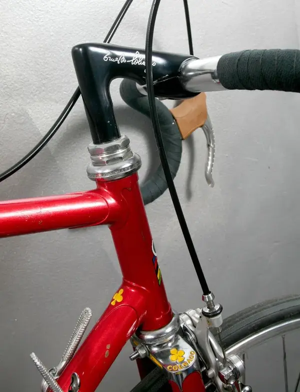

Sorry if this info is a bit tardy, but I own a late 70s Super and the lugs, cable guides, seat stay caps and braze-on shifter bosses are very similar to your frame. The only caveat being that the photos are too small for a full evaluation. Also note that the only chrome on a standard Super from the 70s was the fork crown. I attached a couple of photos of my bike
