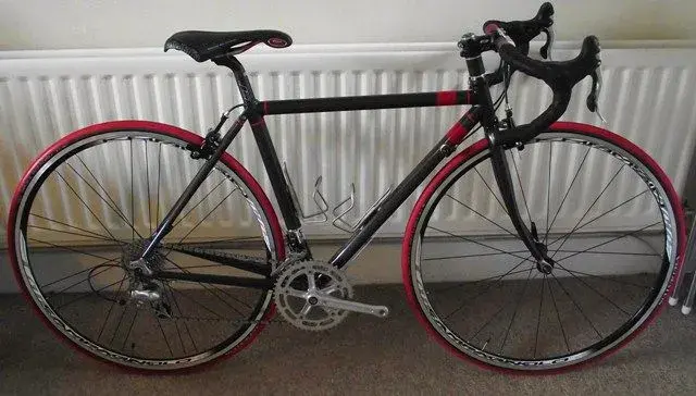

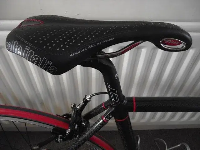

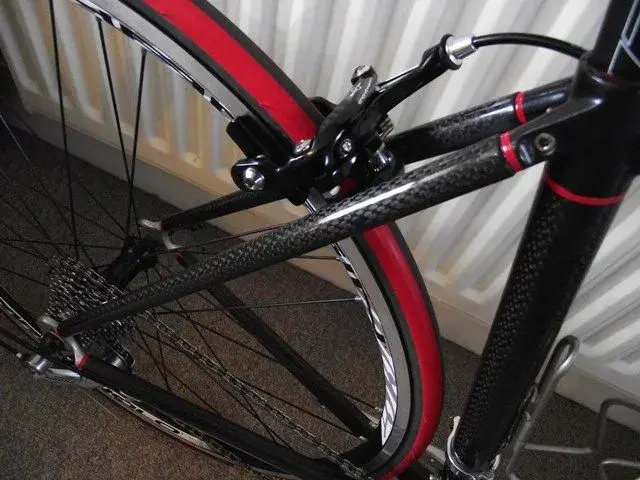

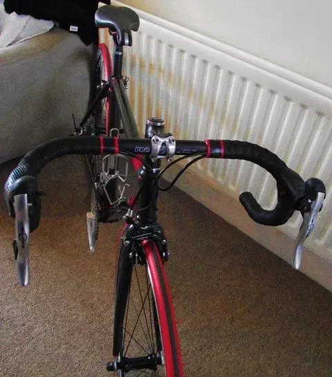

[size=150]Having done extensive research online regarding successful / failed shimergo setups I decided to bite the bullet and just go for it. This how it went. I picked up an early 90's Trek 2500 carbon pro with alu lugs and alu threaded fork on ebay but the decals and lacquer were rough. I removed the decals and wet and dried the carbon to remove the old lacquer then added a few pinstripes and resprayed using simonize clear acrylic lacquer from a spray can and sprayed the lugs metallic charcoal. I swopped the forks with a pair of Alan alu threadless that were on a bigger bike which I also sprayed in metallic charcoal.
Despite reading about new campag shifters pulling different amounts of cable in different gears the new veloce powershift levers index perfectly with the tiagra 9 speed rear mech with the cable hubbubed
The finished spec is
[/size]
Frame Trek 2500 carbon pro
Fork Alan aluminium 1" threadless
Front Mech Campag Veloce 10 speed
Rear Mech Shimano tiagra 9 speed
Shifters Campag Veloce 10 speed powershift
Cassette Sram 9 speed 12-26
Chainset Vintage Dura ace 165mm 38 / 48
Chain KMC X9
Wheels Campagnolo Khamsin with shimano freehub
Tyres Vreidestien fortezza tri comp 23mm
Tubes Vittoria Latex
Bar Pro LT 42cm
Stem BBB 60mm 1" ahead stem
Seat Post Pro LT 27.2
Saddle Flite titanium Genuine gel
[b][size=150]Weight without pedals 8.25 kg
