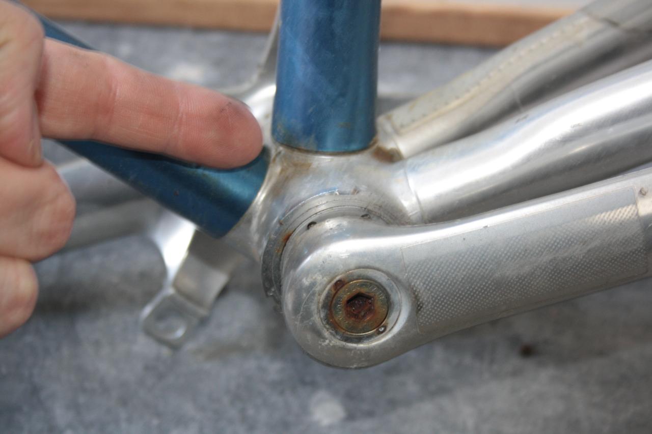

The damage, tube has come unstuck.

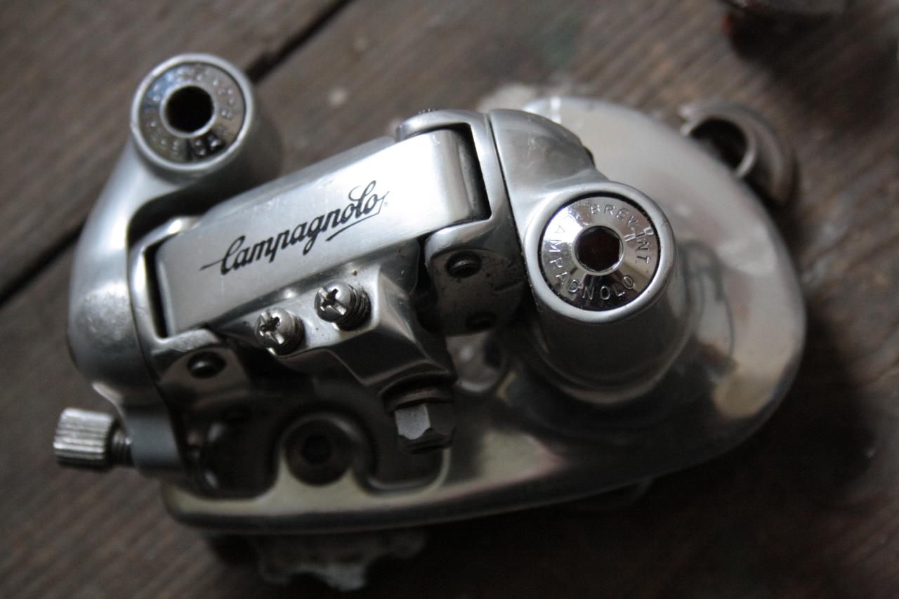

Nice mech, never seen white jockeys before.

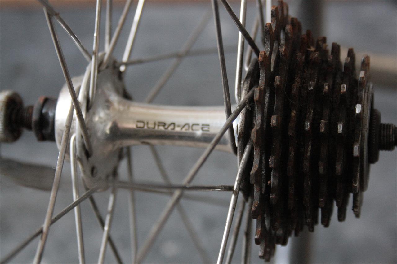

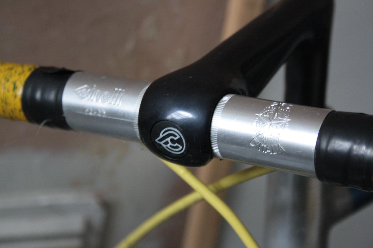

It's a Vitus 979 alright, still has the remnants of it's decals. The components are quite a mix, you have a nice Chorus 8sp r/mech with 7sp Athena downtube synro shifters plus Chorus/Athena brake levers. Your cranks 'look' like Athena too. The wheels seem later with newer style Dura Ace decals though I can't be certain. They look like they should be able to take an 8sp block as the clearance between large sprocket and spokes seems large so shouldn't be difficult to upgrade if that's your thing. Cinelli bars and stem are nice too. All-in-all an excellent find.
Does the downtube bond look dodgy, the fit should be tighter but your pic is unclear. It can be fixed if it's loose but it can be quite a performace.

Glue technology, like most technologies has moved on a lot since the late 70s and 80s. We use a 3m glue for laminating glass reinforced plastic to aluminium at work. The bond is so strong the alloy or GRP will give way before the bond. The problem you've got there is that is one of the worst joints to become separated. You need movement to be able to meticulously clean before rebonding. Separating the other joints to get the movement in the bottom bracket could be very difficult if the bonds are good.

That's the joint that usually goes, bit of a pain to fix without dismantling the other joints. There are a couple of companies who will do the repairs but not sure what the cost is. If the anodising on the rest of the frame is good and not all chips then it's worth spending money on.
