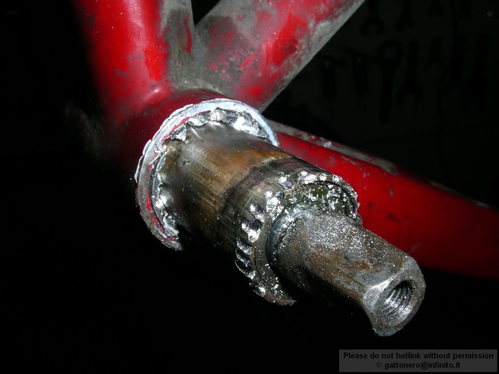

Happened a couple of times.
Sorted by drilling the whole cup all around with 2.5mm holes, then break the spaces in between with a chisel; tapping the b.b. unit out, then cutting the remains of the cup in two points. At such stage, is easy to lift the two halves.
Of course, while cutting the remain of the cup, one has to be very careful. It helps in a steel frame, when touching the threads it feels immediately on the blade and there's no damage.

gattonero wrote:
Johnsqual wrote:
Probably the worst for me so far was having to dissolve an aluminium Chorus BB cup frozen in a steel
frame. BB tool stripped the splines off the cup. Cutting it out didn't get me far - couldn't cut too far for
fear of destroying the threads. So resorted to dissolving with caustic soda. This worked but I then gashed
my finger open on the razor sharp leftotver piece of the cup.
Brr, those pictures bring back traumatic memories...
