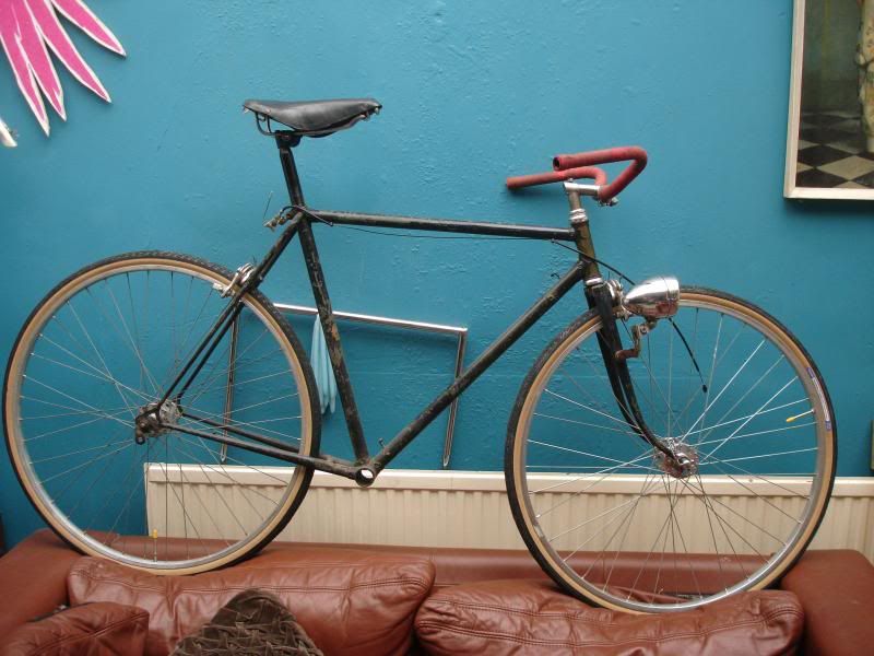

I am building a bike for a tweed run. My last build ended in disaster, i found out it was once in a crash and the TT and DT had ripples. That was a very sad morning.
This is plan two. A early Andy Bone, Nervex pro lugs. 531 and lighter than some of my modern bikes. It's had quite a hard life, not due to me i might add. It is a beautiful frame and deserves a second chance...... I see a re-spray down the line.

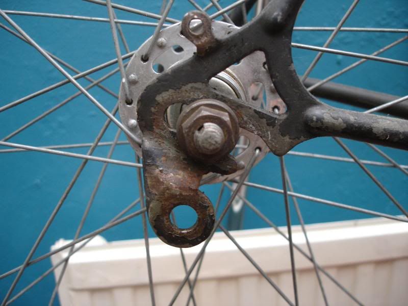

I am having an issue with fitting my rear derailleur. due to the shape, none of my rear mechs fit. I took the bolt from a campagnolo mech and it would not tighten or fit in the hanger hole..............Any advice? What can i do? What mech should i look out for? Can i fit a new bolt in my mech?
The tweed run is next week and really need a bike!
thank you.
LS

Is it not a Simplex dropout?
Rk.

There's a replacement hanger you can got off ebay, I can't think what they are called at the moment! You drill the old thread out, although you may not need to given it already has a bigger hole. Fit the insert which has a very slim nut on the back of it.

A lot of bikes of that ere didn't have threads and you had to bolt the rear mech on.....
Shaun

I guess if you were going to use an early Campagnolo mech you could remove the existing hanger and use the bracket these early mechs came with?

Found it, a hanger saver, one of these:
http://www.ebay.co.uk/itm/One-DROP-OUT- ... 2c6d586075
Push through the back of the hole and screw on your derailleur :)

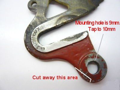

I have found this guide of how to convert the drop-out. Am i being a heathen if i do so? Would a rider of the day have done something like this to make his bike usable? I could put the hanger saver in the drilled hole if i cant find a tap.
"Simplex Dropout showing the area where the hanger needs to be cut away to work with Campagnolo style derailleurs. The 9mm holes also needs to be tapped out to M10x1.0 or M10x26TPI.
M10x1.0 taps are available at many hardware and auto parts stores for a reasonable price. They're a standard size used for spark plug on some motorcycles and small gas engines."

That dropout above is quite a bit different to the one on your bike, yours is pressed and the above is forged.
How about trying to find a simplex rear mech?
Shaun
