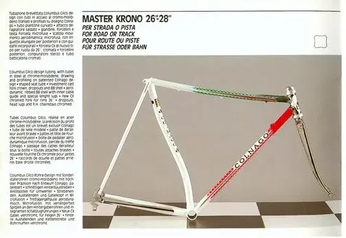

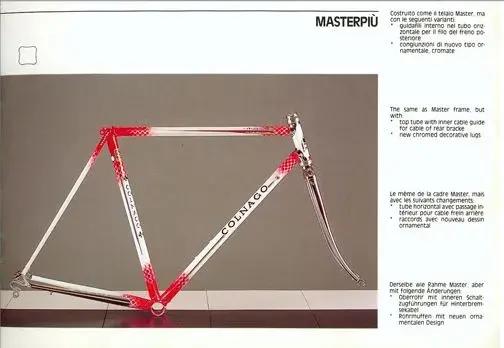

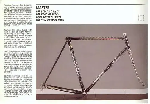

Hi this is my Colnago Master Piu,
viewtopic.php?t=203531&postdays=0&postorder=asc&start=0
The early ones had curved front forks. Not straight one which I think were introduced in about 1988/9. Also the master had external rear brake cables but the Piu had internal rear brake cable.

The internal cable routing through the top tube was not done on any Colnago models before 1987. The 3-pointed lugs on the bike you want to buy were first introduced in 1988 on the Masterpui, so we know it's no earlier than that. However, the seatstay caps on the frame indicate that it is a 90s model. Notice that they are different to the 1988 seatstay caps in Stringfellow's post. You can also get more information by looking at the underside of the bottom bracket too. Early models of the Master had a trefoil cutout in the bottom bracket. After the introduction of cartridge bottom brackets in in the early 90s (1992 for Campag) there was no need for a big cutout in the bottom bracket, and Colnago replaced the trefoil cutout with the word "COLNAGO" written in raised print under the bottom bracket. If this frame has the trefoil cutout, then it's from the period 1989-1992. If it has the raised COLNAGO lettering, then it's 1993 or later.
If it uses a 27.0 mm seatpost, it's a 1993/94 Tange tubeset model.
I will take your word that the bike has been repainted to look like a late model "Saronni" one, and it has been given modern Saronni decals. There is always the possibility though, that it was made within the last 5 years. If it has been repainted, I think it's a shame they've done it up to look like a modern Master, which you can buy from Colnago today. The old Columbus Gilco tubing was superior to the Taiwanese stuff they use today...
