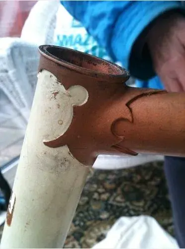

Hello forum, first time poster here, so please be gentle. I have just acquired a frame which I plan to restore, but am looking to date it first. Having emailed Harry Hall's son's shop and got no reply, I thought I would turn to the experts.
It is painted as 'Ted Pritchard' but the frame number suggests Harry Hall - 319HH410.
I have done a few hours of searching but failed to come up with much information on Ted Pritchard. It looks like he might have been a cyclist, then a frame builder with a shop, in Chobham, Surrey.
Harry Hall on the other hand, had a shop in Manchester, now run by his son. It looks like a few people built frames for him, and that he may have turned his hand to it himself.
So is it a frame built in Surrey but sold in Manchester? Or would it have been built in Manchester by Harry Halls builders, then ended up in Surrey with Ted Pritchard's name on it as he sold it from his shop? I guess the model number holds the key..
It is made of Reynolds 531 tubing with Nervex lugs.

I've not heard of Ted Pritchard, but my guess is that Hall's may very well have built frames for the trade (how it ended up at TP's), or quite simply TP had customer for a frame and happened upon a suitable one at HH's.
Many builder's built for the trade, as many shops did not actually build frames themselves, but it was common practice to put the shop's name on a frame.
Suggest rather than email HH's I would call them: might help if you need to make a purchase, even if only a cable set - might help oil the wheels.
If it is an HH I'd restore it as one.

So do you think it is more likely a HH build, painted with TP? The frame number would suggest so? Or could TP have built it and Hall's stamped it.
Hmm, wee phonecall is in order.
I will remember and mention the lugs. Nervex.

Can you provide a photo of the whole frame not just the headtube? TBA, from the photos you have shown, I would say that a frame of this vintage might not not have been built at Harry's premises. It was Roger Kowalski that worked at the shop frame building and his era was possibly out of the Nervex Pro time. I note that the 'flanges' at the top and bottom of the head lugs have not been removed. Most 'craftsmen' builders filed these off but some of the jobbing builders for the trade left them on. Not saying that this means it is not a good frame by any means which is why an overall view would be useful as some small details might help to identify and date it. It also seems strange that a London shop would buy a frame from a Manchester shop (not necessarily known for trade dealings) when there were so many good trade builders in the London area.

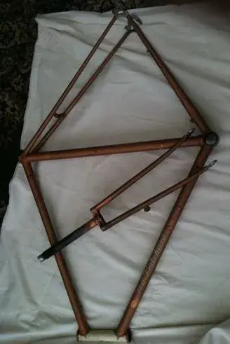

I have attached the only photos I have just now, but they are not great. I will try and take some in better light next week.
Ted Pritchard died tragically in 1968. Not sure if that has any bearing on dating the frame.

You know, without the benefit of close-ups (particularly the seat cluster area) it looks a bit like a Viking to me. They built for the trade and certainly used Nervex Pro lugs on several models.

The lady who sold me the frame doesn't know a great deal about it, but she thinks it was made by Harry Hall's. Unfortunately they got back to me to say they have no records since they moved premises.
It's starting to look like a Harry Hall bicycle, although Old Ned - you have issue with dating it as such? If it is one, I guess I should restore it as one. Although it is a slight shame to lose the TP name. Hmm.
