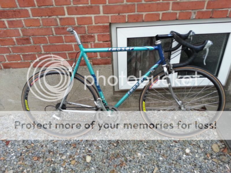

So here are some pics. of the Moser:
Dirty, but that was to be expected with the weather we are having. Front hub bearings needs adjusting, or replacing. Left brifter won´t hold front mech. on large chainring. but... other than that it´s in good nick.
Why are there no saddle, I hear you ask? well seller wanted to keep that, and since that meant getting
it cheaper, I did not mind.
