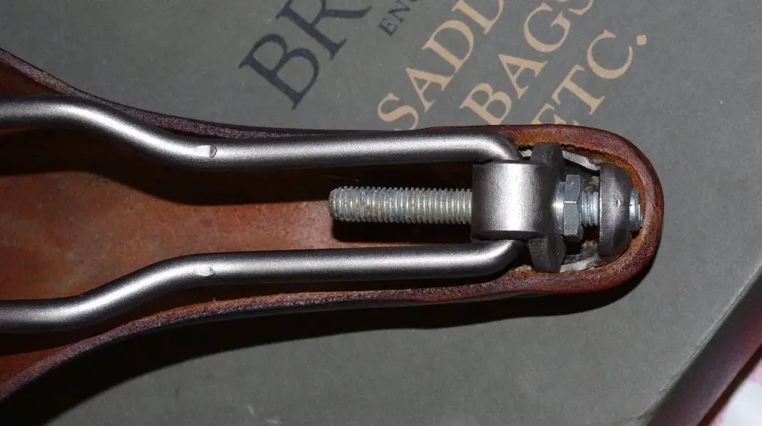

This saddle [Swift Ti] was not bought from anyone on RB
It's nose was twisted and was very generously repaired by Brooks for free.
The they put in a new tension pin and shackle and pinched the nose.
Here is a pic of the tension pin at this very moment in time.
Based its position....would any hazard a guess as to whether the saddle has received a little or lot of tensioning?.....The seller told me the saddle was purchased in December 2012.....I bought the saddle this month.....That makes the saddle about 4 months old.
PostPosted: Fri Mar 29, 2013 8:36 pm
Joined: Mon Sep 24, 2012 9:10 pm
Posts: 928
I have a 10 year-old Pro with the shackle in about the same position as yours- It has been tensioned once by me. The first centimetre of the pin is unthreaded on that saddle though, so the shackle was close to the end of it's thread when the saddle was new. That probably doesn't help you much...You'd need to know whether Brooks ever use that first cm. of thread, available on your saddle, but not on mine. If they don't, then I'd say your saddle hasn't been tensioned much.
PostPosted: Fri Mar 29, 2013 10:30 pm
Joined: Fri Sep 24, 2010 11:51 pm
Posts: 382
Location: north of essex, south of suffolk
yup
thats been adjusted, i'd say a lot more than necessary for its alleged age
no wonder it twisted
here's what you want, my swift. 4 years old, adjusted once.
The pin on the Swift Ti is threaded all the way...no un-threaded portion whatsoever.

pondlife wrote:
yup
PM sent....to be sure is yours a Ti Swift too?
