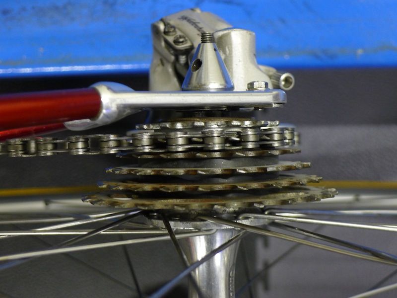

This is my 6 speed block (in second top gear) on a Mavic 500 hub, there's not a lot of clearance between top gear and the frame

If I recall correctly the seven speed freewheels came out a few years before bikes were routinely spaced at 130 so I would guess this is no problem. In fact, as many have already noted, I am running a seven speed on a 1975 Colnago spaced at 126. I must admit however the shifting is a bit slower than with six speed setups, maybe because the extra cog allows for a greater range and the rear mech has to "stretch" to get the last cog?
