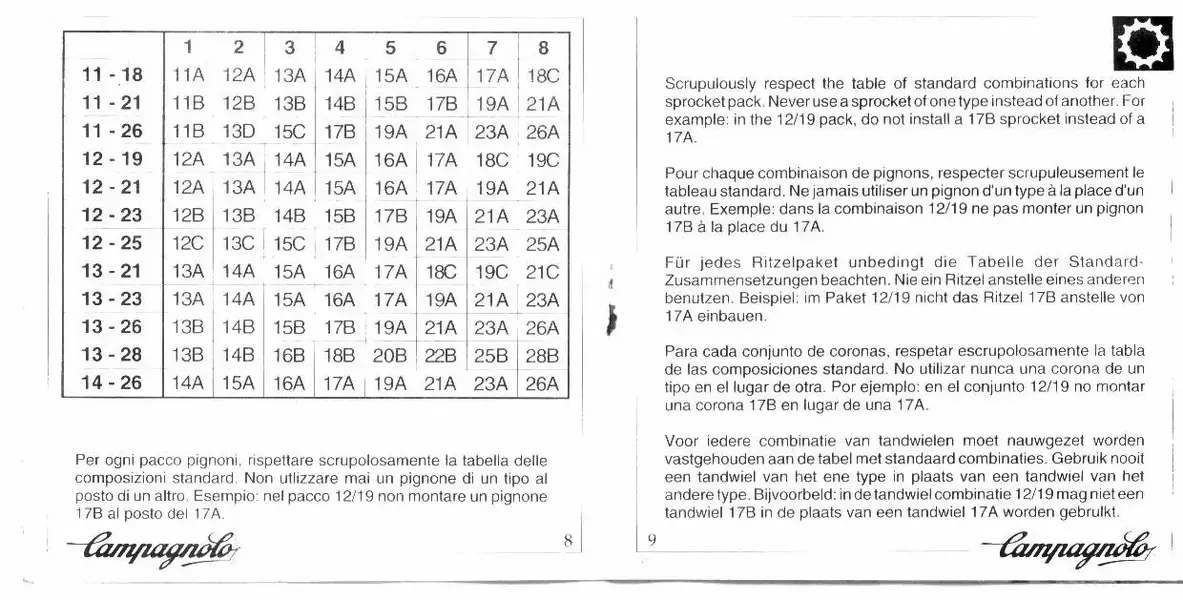

So, after my last post, I realised that some people might want the technical information to build the best cassette possible. I pulled out my old ExaDrive sheet...
When using ExaDrive cassettes, there is a letter assigned to each sprocket next to the number of teeth. This is not the same as the letters on the pre-ExaDrive cassettes, so you need to be aware of what cassette you are installing.
For optimal shifting, you want to stick to the table, but it will still work, even if you don't follow the table.
In the case of a 12-26, it's interesting to note that Campagnolo have never produced this combination. I would suggest running the desired cassette combo through Sheldon's gear calculator just to make sure you choose sprockets with a good range and no overlap...

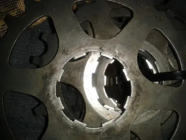

PostPosted: Wed Mar 20, 2013 9:02 pm
Joined: Tue Jul 20, 2010 8:22 am
Posts: 2170
Location: Warks
Cool, so my guess at the 12-26 combo is identical to campy 12-25 bar the last cog; btw, mine are pre-exadrive, ( I think? ) no keyed spline, they are all the same.
PostPosted: Wed Mar 20, 2013 9:26 pm
Joined: Thu Jul 19, 2007 7:18 pm
Posts: 3805
Location: Staffordshire

PostPosted: Thu Mar 21, 2013 7:27 pm
Joined: Tue Feb 23, 2010 1:56 pm
Posts: 1051
Location: West Yorkshire
bikenut2010 wrote:
OK thanks very much, in that case how would you recommend arriving at a working cassette without too large a jump?
13-26 (13-14-15-17-19-21-23-26)
12-23 (12-13-14-15-17-19-21-23)
In both instances all I can see is 12-13-14-15-17-19-23-26 using the 12-23 and replacing the last 2
or 12-13-15-17-19-21-23-26 using the 13-26, adding the 12 and removing the 14.
Appreciate your experience! :)
I would avoid that 19-23 jump personally. Best bet is to use the 13-26 but take the 12 and 13 from the 12-23 to replace the 13 and 14. You can't move the 13 from the 13-26 up a position because it has the serrations for the lock ring in it.
I assume your hub is pre Exa-drive otherwise the old cassette won't fit.
Mark.
