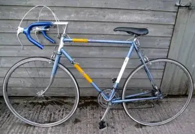

Hi all,
Im after a little advice and maybe some help, ive just picked up a Carlton Criterium that im looking to restore and maybe respray.
It seems to be in pretty good condition mechanically, just a rounded crank on the nds.
The previous owner hadnt ridden it in over 20yrs :)
Uploaded with ImageShack.us
Heres a few details.
WL900154 (S) stamped on the bottom of the frame (August 1979?)
73 stamped on the headtube
The bottom bracket has 1.37 x 24t Japan Tange KT, (so im guessing its its standard british)
Suntour VX Rear Derailleur, Suntour Power Shifters, 52/42 front ring
Raleigh Wiemann 610 Brakes
Rigida 27 x 1 ¼ Rims, with Hague Hubs (seem in good condition, slight buckle to rear)
My plan is to keep it as is for the majority of components, new saddle & bar tape are needed.
However i would like to strip it all down and get it resprayed/powder coated.
First question, if im going to respray i will have to remove the BB and as i havent done this before whats the best technique and tools?
Also would it be best to refurb or replace the BB?

From here it doesn't look like it needs a repaint.....

To remove the BB, first remove the cranks (both sides(but you knew that, anyway, didn't you?)
The, at the NDS, use one of these: http://www.bikegoo.co.uk/product.php/49 ... tAoddyEAuQ
to undo the lock ring.
Then use one of these: http://www.cyclesurgery.com/pws/UniqueP ... tAode3gAEQ
to undo the cup, or if you don't have one, and don't want to buy one, a pair of long nose pliers usually works. Undo until the bearing fall out, all over the floor and disappear under the fridge/workbench/cat. Pull out axle and put to one side. Turn frame over and put BB shell over a plastic box or tin and shake frame until all DS bearings fall out.
Then try to remove the DS cup.
Spend 3 hours seeing how many ways you can find to cut yourself whilst doing this. Eventually give up and grab the blowtorch (if you are going to repaint then no problem, if not stop here and get the LBS to do it). If repainting, light the blowtorch and apply heat all around the BB shell on the DS. An occasional tap with a hammer can help hear too, what you are trying to do is to break the corrosion. Once you get bored of doing this, grab some TF80, plusgas or the like and liberally spray the cup and shell (you are doing this outside, aren't you?) Mind you don't burn yourself.
Once it has cooled, find a large, heavy workbench and strong vice. Place the flats of the cup in the vice and close the jaws of the vice to grip the cup. Now use the frame as a lever to undo the cup, remembering that it is LH thread (so undo the opposite way). If it keeps slipping, try using a large bolt (M24 or so) and nut, put through the axle hole, to keep it from falling out of the vice.
Good luck!

Thanks for the replies, regarding the paint job it is quite pitted around the forks and chain stays but i agree i could just clean it up a little.
I will get a pick up the parts needed as i really want to use this as a learning experience as well as a restoration :)

This was quite funny and boy have I been there done that.
One other option if the cups are still good you could just replace the spindle. Be careful to look for one from the same manufacturer and the same length as the current one. Also it should be stamped "68" for English BB width.

+1 Maybe I've just been lucky, but using a vice has always worked for me without any heat. Although, it always takes some figuring out which way is clockwise to loosen once the frame is upside down and clamped in the vice :facepalm:
+1 On the leave the paint. Always hard to tell from one photo but the paint looks good to me :)

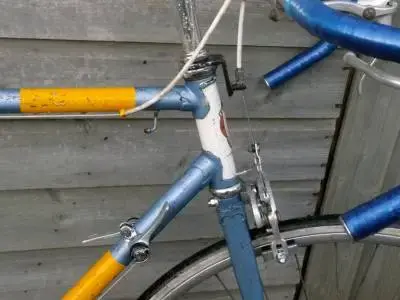

Hi there dont mean to hijack the thread but I've just bought what I think is a Carlton Citerium, though the frame number, 130704, would seem to date it to between 1968-72, which seems rather early compared to most I can find online. Can anyone shed any light on this for me? Many thanks
