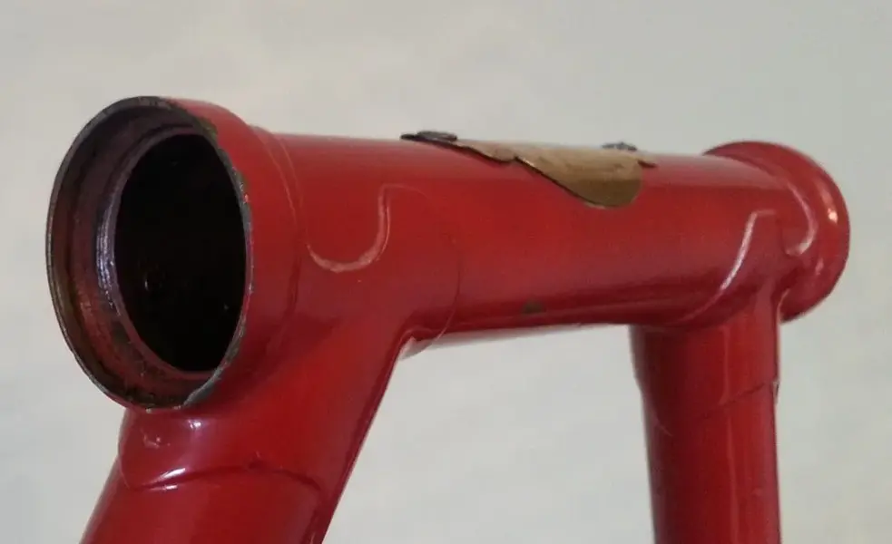

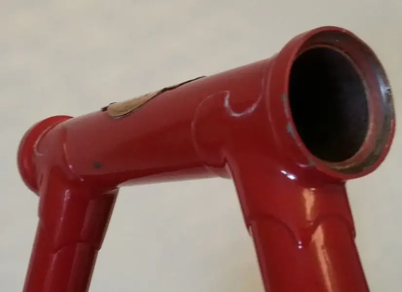

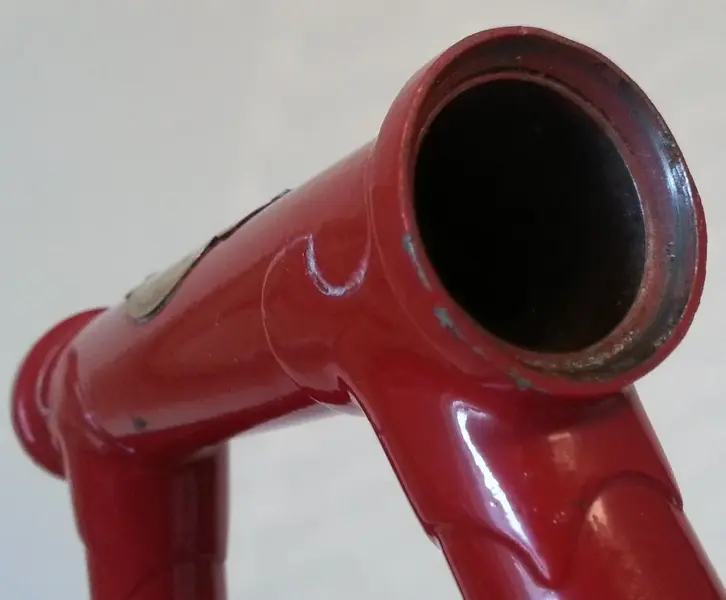

So I am starting to assemble my late 40s FHG and I'm confused about the headset. I realise traditional threaded headsets have 'cups' that the bearing races sit in which are pressed into the frame. On my frame, these 'cups' seem to be part of the frame itself. So I don't know what sort of headset will fit.
All advice greatly appreciated, heres a few pics.
Cheers

The older bikes that I worked on had separate "cups" that sat in the frame into which the ball bearings went, not a modern type cup that is an interference fit in the frame just a holder for the ball bearings
http://www.bikeforums.net/showthread.ph ... rack-Frame
I don't ever recall seeing a frame where he bearings went straight onto the frame metal, mind you it was nearly 40 years ago. Keithglos on here might know.

older frames had headclips which yours seem to be..........

I have two bikes with type, one tandem and one fixed.
The parts come up quite regularly on eBay, or you can try the Tandem Club, they have a selection of the cups in their shop.
FWIW it looks like the cups are built into the frame, but they are not. The cups sit in that recess, which makes fitting a right royal pain in the arse as they are a loose fit!
