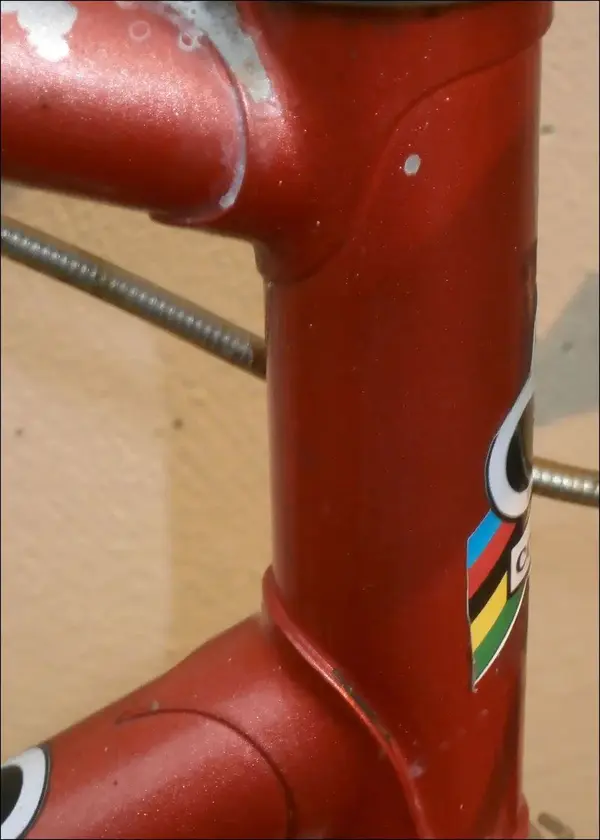

I figured this person didnt know what they had on their hands, but then myself and a friend inspected it in a room which had a light and realised quite quickly this was not a Colnago. The frame is very light and does seem to be in great nick, save the paint fading on the top tube and a load of chips. The stickers look to cheap and aren't lacquered into the frame in any places however the Columbus SLX tubing sticker is. (The head tube sticker looks as though its been placed on top of an older removed sticker which has even left some residue behind!?)

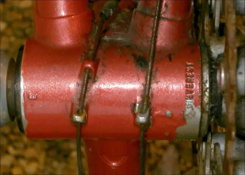

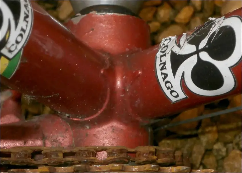

The lack of any usual Colnago markings on the seat stay, bottom bracket and other lugs is the clearest indicator. the bottom bracket does however read "EVEREST".

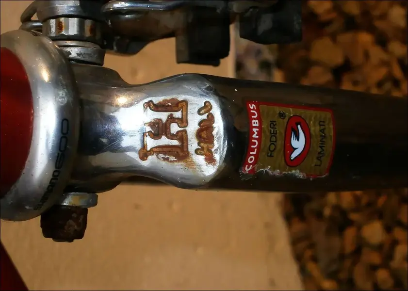

But checking the manufacturing company's website seems there is little information of individual parts etc, also the company is based in Taiwan, not Italy or any other part of Europe. The Forks read Hall on the crown and again state there Columbus heritage.

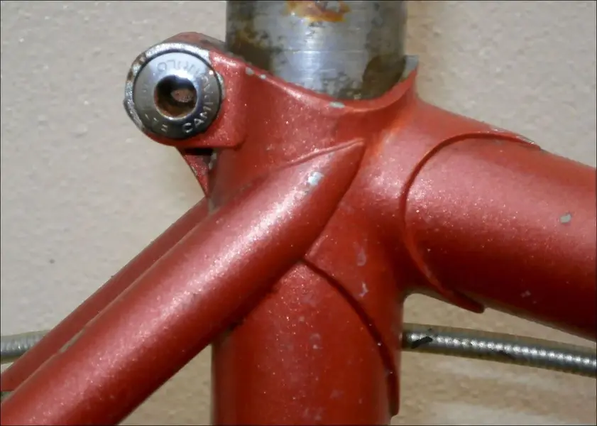

So these parts i think im aware of, however i would love anyone to get in touch and let me know if this frame is legitimately Columbus. If its reputably any good? (as im looking for a decent steel frame to replace my Vitus 979) Also what ideas would any of the forum users think i could rebuild this bike into?

The fork looks like this Harry Hall one. See here.
http://bikefood.com/index.php/frameset-1/
The whole transaction sounds a little dodgy!

Yes i agree it does seem the same forks. I did google Harry Hall but it only went to their main retail shop.

Colnago and other brand decals were commonly available late 80's/early 90's and lots of them got stuck on all sorts of frames. If this is a Harry Hall as it appears to be then you've still got a reasonable buy with the components that are fitted. Perhaps a bit more than at a jumble but still OK. HH frames of this era are well respected.
Everest is probably the maker of the BB shell.

The frame appears to be well made so that is a good sign. After looking at a handful of Harry Hall frames I did find one from 1990 that has very similar lug work and seatstay caps. Is the Harry Hall Cycles bike shop the same company as before? if so send them that serial number and see if anyone there can shed light on the origin of the frame.

Yes if it's Columbus SLX there should be helical reinforcements inside the tubes around the bracket. Either remove seatpin and shine a light down there or remove bottom bracket and feel around in there. If the reinforcements aren't there, it doesn't mean it's not Columbus, but it's not Columbus SLX. This looks like a quality frame... a framebuilder can't think of using shortpoint lugs like that without making a stab at mitreing the tubes properly. Plus chrome rear triangle probably wouldn't be found on any old bike... To be fair to the seller, it doesn't sound like they were passing this off as a Colnago, but they obviously knew enough to charge hundreds for a tatty bike with a rusty chain, if you get my drift? If it's all cleanable and serviceable, then fair enough... and I doubt many of us could tell it from a period Colnago anyway as far as ride goes..
