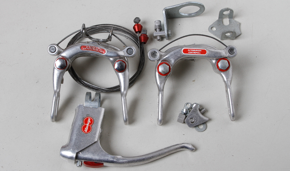

It came with a Weinmann 500 on the back and nothing on the front. I've measured the reach on both to be 55mm, but ideally I want a caliper that I won't need to change if I ever end up changing to 700c. So I need a caliper that can reach to both 55mm + 59mm right? So far I've only found the Weinmann 730 that satisfies this (and from what I read the braking might be a bit rubbish?). I'm not to worried about it being the right period as some of the components are already a bit of a mix. Ideally I'd want something that doesn't look too modern though. Any suggestions on something that might be suitable?

Go for an old set of Weinmann, Dia-Compe or Mafac centre pulls. Lots of range and good braking performance. Will look right too.

Yeah that makes sense now actually. Not sure why I didn't consider that in the first place! I'll keep looking at eBay. Thanks for your help.

I have a pair or 2 of mafacs if you pm me i will do pics to your email addy.. top ones are approx 30 quid posted others about 15 posted.. will
