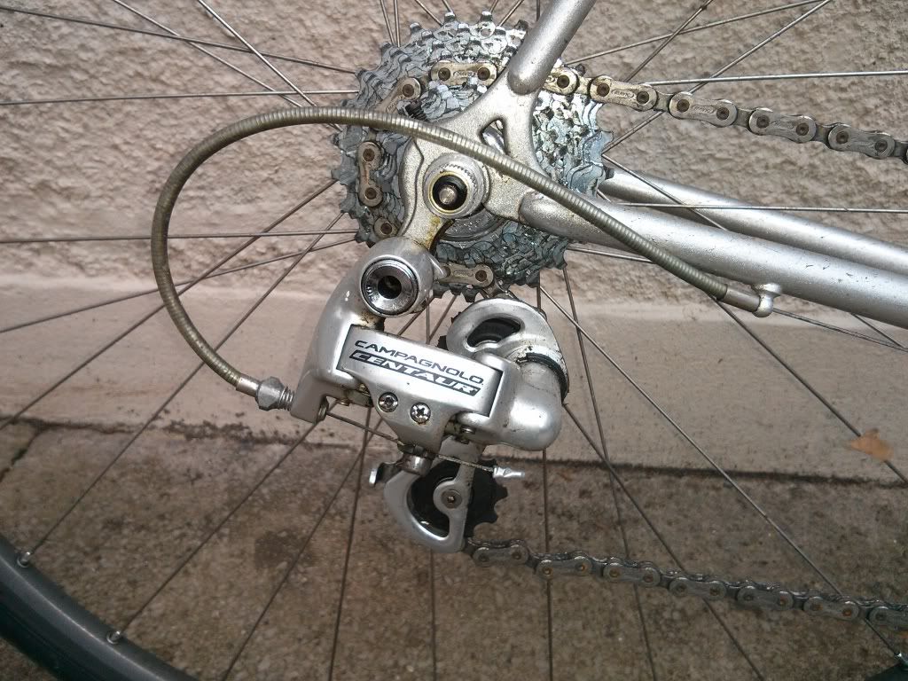

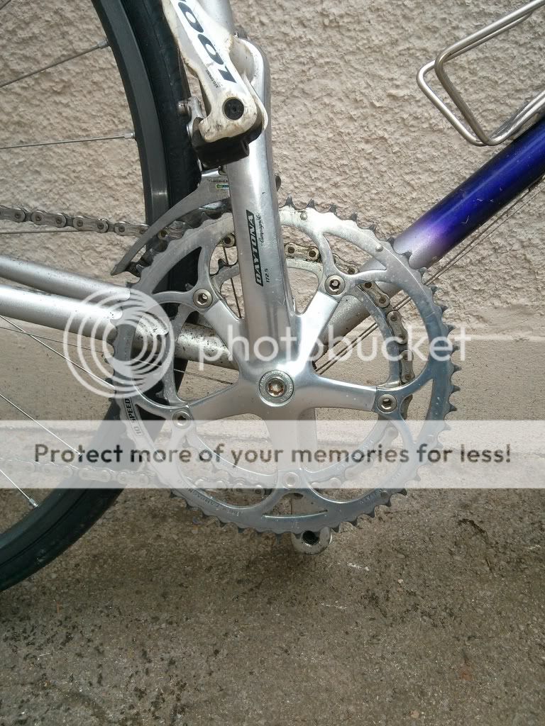

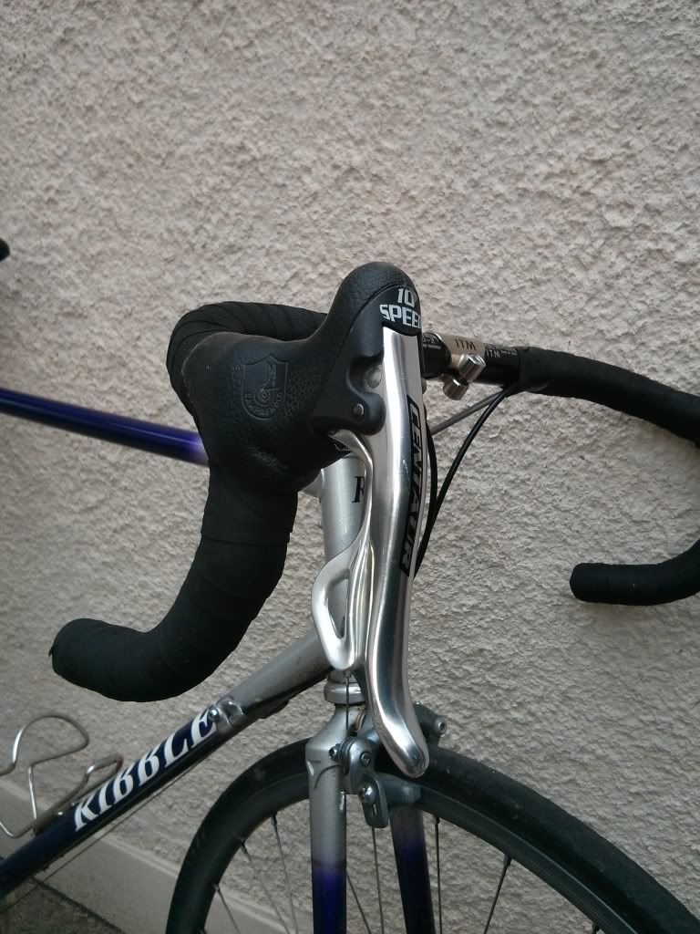

Some of the 10 speed centaur/daytona bits I'm using
I've got Centaur 10sp alloy Ergos (working a Sachs 8sp set-up) on my CX bike. Good levers those, giving the right balance between price, performance & build quality. Recommended.
