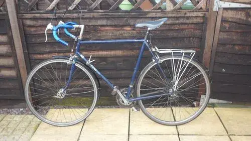

I just won a Dawes Galaxy (Reynolds 531)off eBay. It seems like a good investment & worthy of restoring. Plan is to strip the frame & re paint, then rebuild.
The stem & seatpost move OK (I took the stem out,It has a round wedge type of thing that pulls into the frame when the allen bolt is done up.)
Before I take the frame to bits, what tools will I need to remove the Bottom Bracket? & will a shimano cartridge BB fit as long a s the length is right. I'm assuming the width is 68mm, but I'll check later.
Sorry about the rubbish photo, as it was the one on eBay... I'll take some more later & post them
Many thanks & looking forward to your replies :D

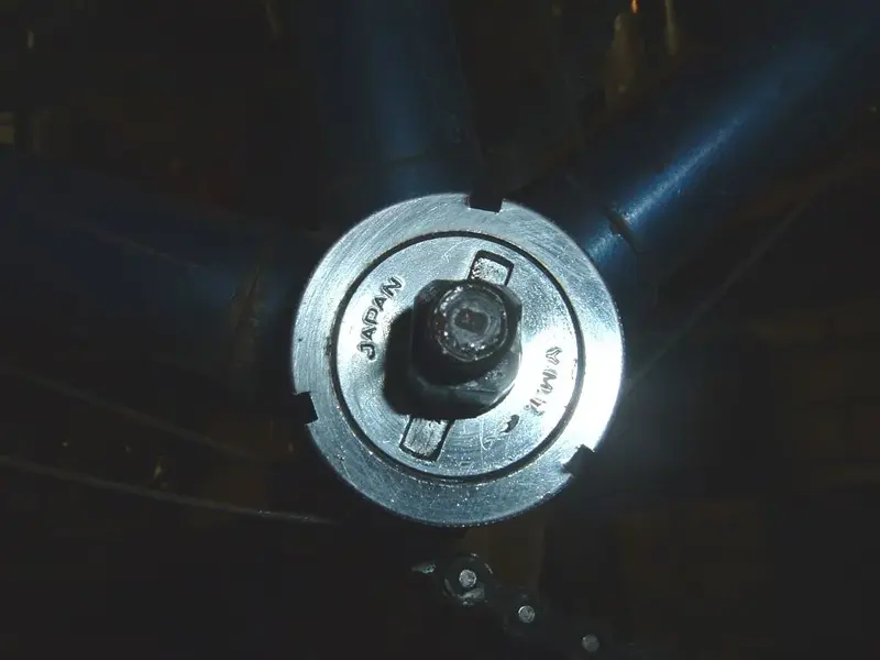

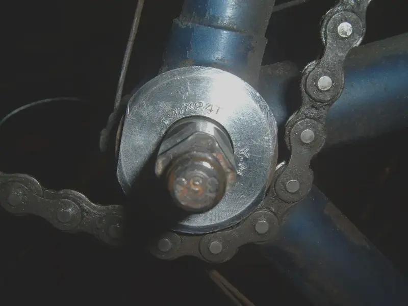

Here are the pictures I took of the bottom bracket. Both sides are here. I looked around on the internet & found out that the threads are pretty standard.
Any Idea what tool fits the non drive (lock-ring centre) side?

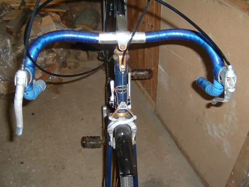

Also, you'll see from the handlebar photo that the ferrules that house the cables that come out of the top of the brake levers are different. I assume that one was broken at some stage & replaced, but it's pretty ropey. Is there easily available replacements? Or would I be better of investing in a pair of the side exit levers that I've seen. I assume with these you run the cable inside of the bar tape.
Sorry for my lack of knowledge on road bike & appreciate your help

PostPosted: Sun Feb 24, 2013 11:18 pm
Joined: Mon Sep 24, 2012 9:10 pm
Posts: 944
Paul Chambers fan?
I would normally recommend a set of headset/bb spanners as in my avatar, but they are not designed to work with an adjustable cup like this... will do the fixed (drive-side) cup though. I don't know what are the specific tools for this sort of adjustable cup... I've removed one myself but can't remember exactly how! probably by knocking the lockring loose with an old screwdriver, and then unscrewing the cup by hand... may have clamped the exposed threads in a vice with soft jaws and turned the frame.. Luckily for me the cup wasn't tight/siezed.
