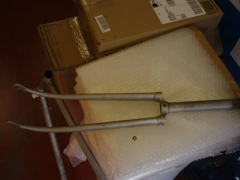

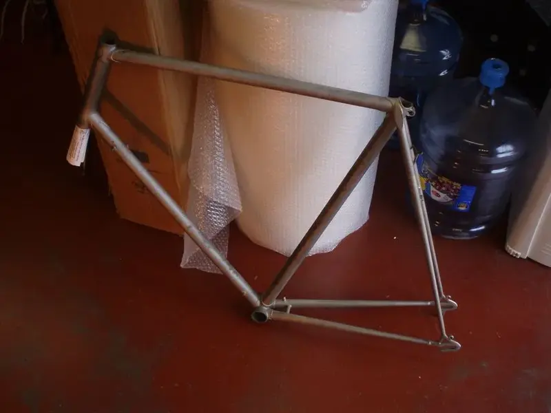

The frame has now gone down to Argos cycles in Bristol for a respray. The frame really would need the chrome re-doing, that is just far too expensive so it will be solid colour frame & forks, red, white lug lining as per the original paint job. Frame should all be sorted by beginning of April. I took a few pictures after shot blasting.

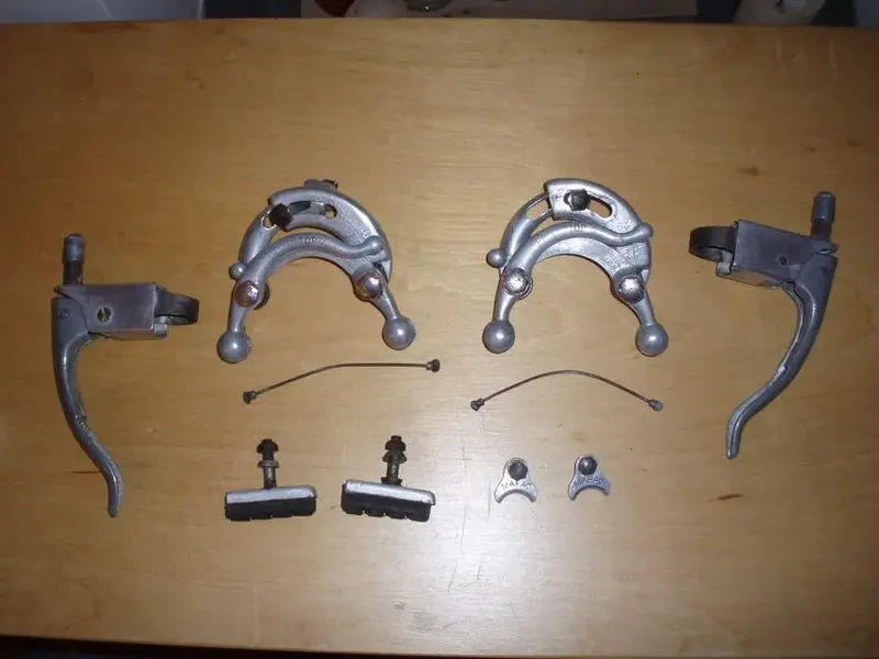

In terms of the components, speaking to my Dad it seems that the frame was never built up with a full groupset per-se but a collection of lightweight quality parts:
Brooks saddle, GB ventoux bars, Ambrosio gran-prix stem, Mafac centre-pull brakes, Record front mech, Simplex rear mech, Stronglight chainset, Weinman sprint rims on Record hubs. Some of this I have, some I don't and will need to find! In terms of the restoration I am going to take a pragmatic approach and use a mixture of components up to the late 1960's - I don't want to spend an absolute fortune and want this to be a bike I can ride not just keep as a museum piece.
Here is the first of the bits cleaned up (I do realise the value of these having done a quick ebay search!):
As you can see I'll need to source a pair of replacement threaded Mafac brake block holders (two have been broken/lost and replaced with modern brake shoes) plus the small aluminium tapered washers used to position it around the caliper arm, although I can probably spend some time with a file to trim down a modern aluminium washer into the right shape.
And potentially replacement rubber hoods, I had seen modern Cane Creek hoods which may fit, rather than trying to find true period replacements.
Anyway that is enough for tonight, any comments / help greatfully appreciated as although I have build my own modern road & mountain bikes, I don't know much about restoring a classic bike!

Nice.
Back in the 70's which is my era the "groupset" (full Campag) was only for very rich people or sponsored teams and we bought what we could afford new , thought looked nice or got second hand from other club members.
Before my time there was no "groupset", just companies who made their line of goods.
The downtube braze ons are interesting....are they for a mix of bar end shifters and downtube, just can't make it out on my screen?

I seem to remember 'twas quite a common request for "testers" back in the mid to late 60's to have their frame built with a brazed on boss for a down tube rear gear lever and a bar end shifter cable stop for the front, not too sure why though maybe some folk thought it was a more ergonomic arrangement when shifting at speed,
........as for the Mafac Top 63's that you have they are in no doubt one of the rarest and most sought after brakesets that collectors want, you'll get lots of interest if you ever sell them!

These brakes are very rare to find. The levers are Universal, I think. There are some NOS rubbers for them on Italian ebay (if I assume rightly that they are Universal):
gum colour: http://www.ebay.it/itm/Universal-Brake- ... 460c4df8ea
black: http://www.ebay.it/itm/Universal-Black- ... 43b8446248
white (but adjuster cover missing): http://www.ebay.it/itm/Universal-White- ... 43b83fe54b
Period correct MAFAC levers would be probably 'Course 121'.

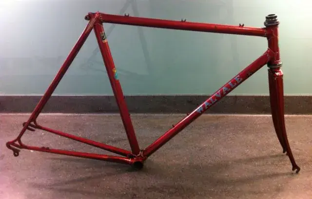

Yes I see what you mean, one looks too big, the other too small. I think the larger transfer should be ok for my frame though, it is ~25mm high which the frame resprayers thought would be about right once wrapped around the downtube.
I was using another frame I saw on ebay as a reference for the decals:
The decal here looks quite big doesn't it?

Maybe thats what it was as mine was a more modern frame being from the eighties. Slightly defferent decal set up on mine.

Here some more about 'top 63', ultra rarity: http://www.classicrendezvous.com/France ... _top63.htm
These are proper levers for the calipers (from velobase):
Here are MAFAC course 121 on French ebay with hoods in quite good shape just lacking the lever's 'sleeve' but the base is the same: http://www.ebay.fr/itm/LEVIERS-DE-FREIN ... 589c041319
Maybe it would be better to complete it with MAFAC levers than buying hoods for Universals?
Can ordinary (from 'Racer') MAFAC brake shoe be threaded? Do you have any spare to compare if they are the same?
I am looking forward to see restoration and new photos.[/quote]
in my humble opinion I think you should keep the original levers as it was the done thing back in the 60's to have your Mafac centre pulls coupled to Universal levers as the full hoods on the Universals offered much better grip and cushioning, I can't recall anyone in our club not using this combination on their lightweights......if you do decide to change anything I would suggest that you offer the Top 63's on eBay (Worldwide) where they could possibly raise £200.00 or more and then purchase a pair of clean Mafac Racers (approx.£25.00) that would be perfectly in keeping with the era and the money you have left over would fund a large portion of your rebuild
