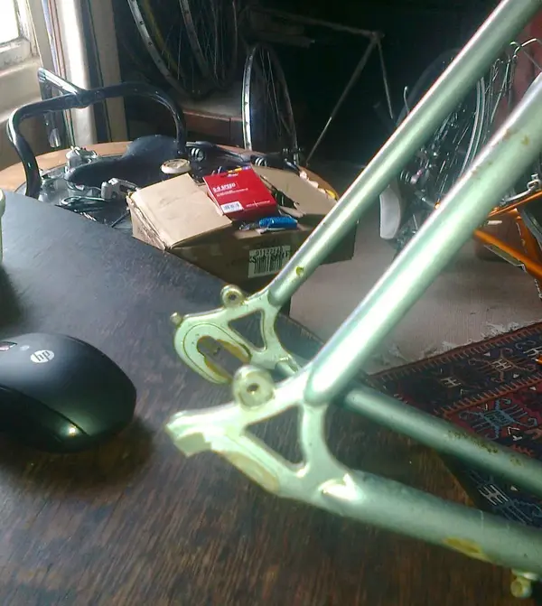

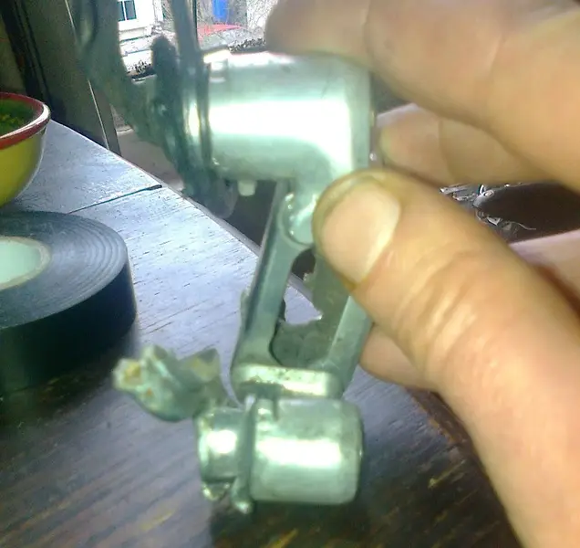

Unshipped the chain into the spokes, which locked-up and pulled the derailleur up and into the wheel snapping the dropout in the process, along the line of the adjuster screw.
It's only my beater Winter bike (1980's Raleigh, 531 main tubes, £50 for the whole bike), so I'm not too pissed off and I've had my money's worth from it.
I'd rather not skip it though, it's a perfectly decent hack. Getting the dropout replaced is certainly feasible and I was even thinking of getting track fork ends put in while I was at it.
Having a quick check online though it looks like it would cost £100-odd. I'm sure I could get the price down a bit, but even so that's a fair whack to spend on a modest frame.
Is this the sort of job that a competent engineering company could do, or does it need a jig?
Any other options/opinions/advice?

Just out of interest can we all see a picture of the damage...please :cry:

To satisfy Ian's bloodlust, here are a couple of snaps:

Oh, ok, that looks quite bent as well! In that case I'd still weld it, but I'd get another drop-out, cut it where the other one is snapped and use the same method. Just make sure the new drop-out is the same thickness as the old one or the wheel nut won't seat.
