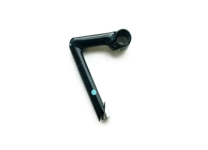

Hi Hamster, thanks for the advice but that technique won't work on this stem as the bolt only goes in one way and there is no threading on the lower section - pic below -
