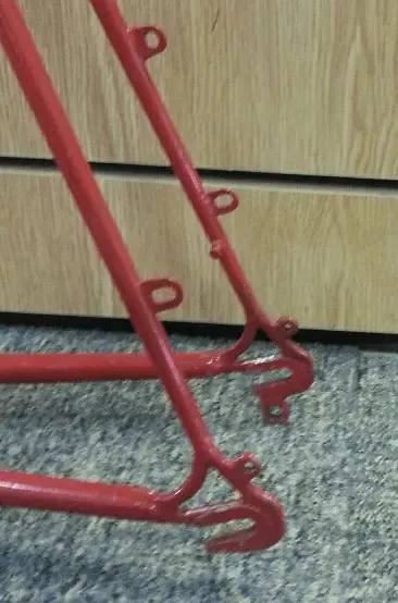

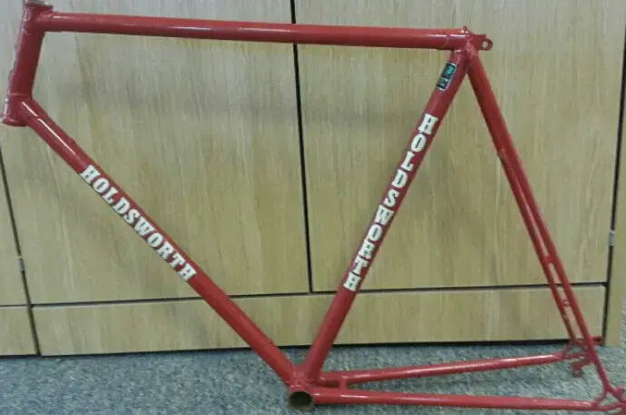

New poster here embarking on my first build on an old frame. What I have is a Freddie Grubb frame (previous owner believes it to be 1949 but I'm not 100% certain). I wanted to post a few pictures in a hope that someone can help me date the frame and also some suggestions in what direction to go with the build, any advice and a place to field my often stupid questions.
The interesting features of the frame that are making me question the year are the grease nipples on the headtube and the holes for the nipples on the bottom bracket.

Hi, looks late forties, but the grease nipples in the headstock and mudguard tabs point to it being a touch earlier than 1949. Check out readers bikes on the classic lightweight website for ideas, single speed is easier but the depth of your pockets and parts availability will dictate the build. Good luck Terry.

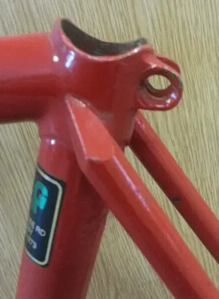

Looks to me as if the rear dropouts have been replaced at some time with ones suitable for mounting Campag or similar rear mech. Period ones would be plain or 'Osgear' style not cast ones as shown. It also appears to have a headclip style headset arrangement with integral races that date it to probably 40's/. Do you have the forks?
I'd agree on the likely dropout replacement with the gear hanger....those short horizontal dropouts were popular in the 1970's

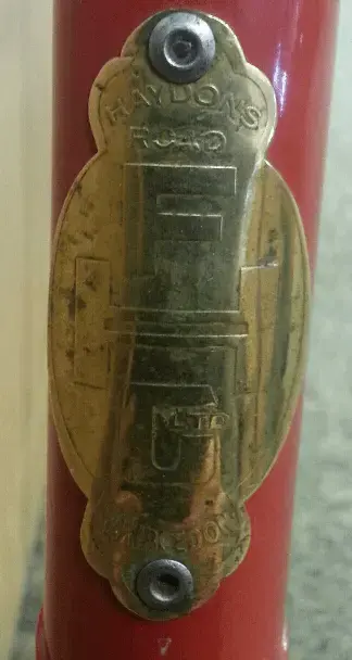

It looks early post WW2, perhaps 1948/9. It is definitely not Freddie Grubb, that was the name the Holdsworthy Company used. It could be F H Grubb. Probably had a head clip. Anything on the cast lugs? Or under the bottom bracket?

Don't remember "short" dropouts having mudguard eyes.......mind you might be my memory LOL
Look like longer dropouts, not original but could be older than the 70's.

There is nothing on the bottom bracket, the only markings I have found is above the badge as per the pic.
