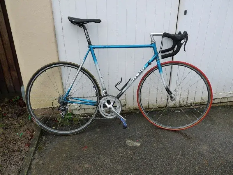

Here's a pic of the bike

Oria Tubing is not to be sneered at :) My Moser is made of it and is pretty light, the Moser just needs repairing so I can do something with it LOL
If the seat post slides easy and clamps up OK with the slot in the metal of the seat lug essentially parallel then should be OK.

Looks very similar to the Olmo frame I have (there's a pic in the Retrobike SS thread). It's a light frame, almost as light as my Ribble Reynolds 653. I also have a red Olmo Giro (late 90's i'd say as it has vertical dropouts) and my Father has a Silver/Blue Olmo Giro that he's slowly building up.
