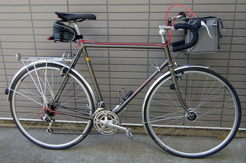

It's a Richmond Cycles frame all right -- or if it isn't, then when I look at your photos and imagine your frame not covered with cleaning goop, it looks remarkably like the frame of my bike:
(that was last year; I've made a couple of changes since). My frame, bought from Richmond Cycles (in Twickenham) in 1987 or so, is for 700C; the previous year I bought a mixte frame for my then-GF, now-missus from the Richmond shop of Richmond Cycles, and the mixte is for 27 inch.
So how did your frame come out of the wash, and how do you enjoy the resulting bike?

Looks much like a mid to late 90's Panasonic touring deluxe but that appears to be Reynolds. Back in that era 80% of the touring frames were Anthracite grey in color,

Yes, mine's "Guaranteed built with Reynolds 531®ST fork blades, stays & butted frame tubes". (Or so it says. I wouldn't know, but the seat post is indeed 27.2 mm.)
Now that I come to examine it, the lugs turn out to be different from those shown by ForestHill. But the seat stays wrap at the top in the same way (they do on the mixte, too).
Mine has a subtle hint of metalflake in the grey paintwork, and there's red lining around the lugs. It's definitely from the 80s.
