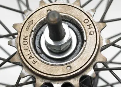

Thanks for the replies so far. I was hoping to get the freewheel I have off without dismantling it.
My problem is the indents for the freewheel remover tool - they are like the ones in the picture: too shallow, thin and far apart for a normal two prong freewheel tool.
It seems the only way to remove a f/w like this is to dismantle it - unless anyone has an alternative.

Surely you just need the right remover? BITD we had a number of "two pronged" removers of varying designs.......

Pardon my complete ignorance, but why would a frewheel remover of the correct type not fit into the two slots visible in the pic?
If you have one or are able to adjust one - with a file (i had to do this recently) to fit and put the QR back in tightly then unscrew the frewheel a little - release the QR a little, unsrew the freewheel a little ... and so on until it is off.
Have i missed something?
