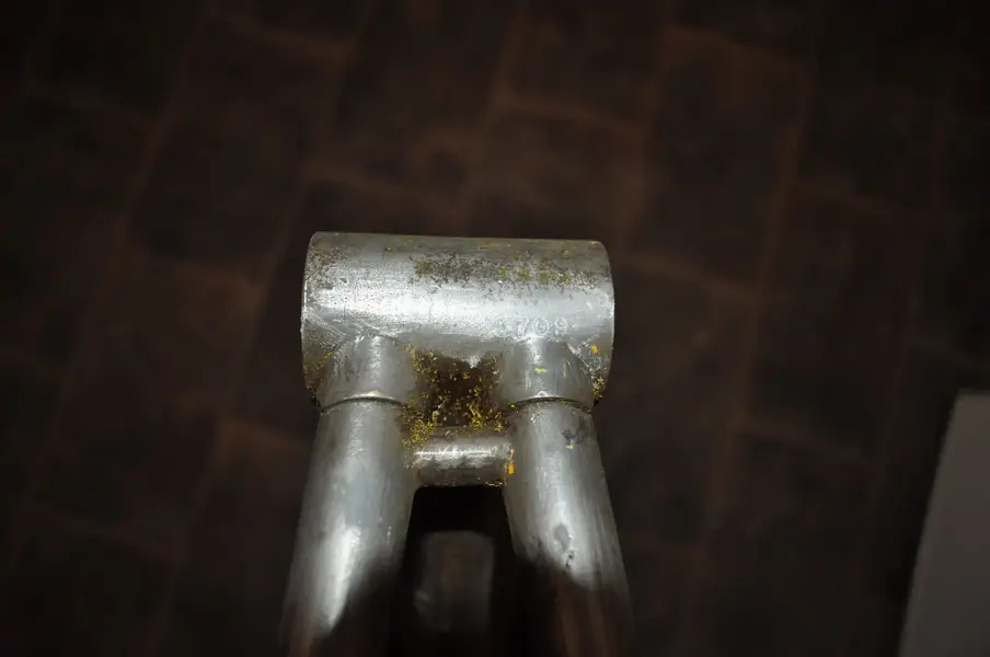

Photo of frame number.
PostPosted: Thu Jan 24, 2013 6:56 pm
Joined: Thu Dec 13, 2012 5:49 pm
Posts: 268
Location: Lincolnshire
Same place as my number
