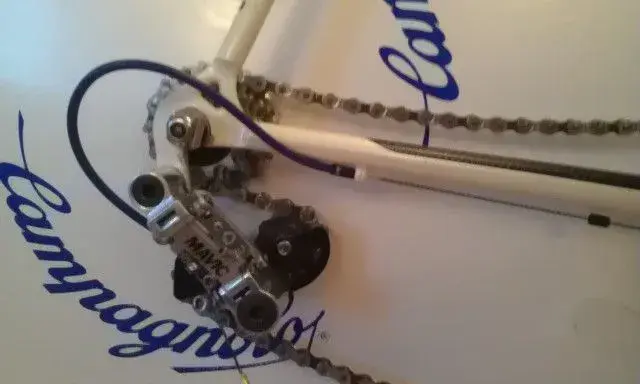

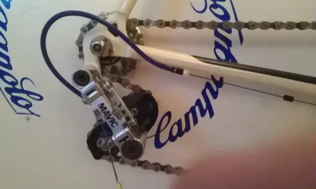

Tel wrote:
Does the mech keep tension through the gears? If you stop turning the crank does the chain snag on the freewheel hence make it touch the chainstay?
No issue at all when running on the 53 ring through the freewheel.
different ball game when on the 42 ring - chain just goes slack?
pics attached...top pic is 12th gear with everything tensioned nicely, goes through the gears no problemo - note chain tension..
lower pic is 3rd gear - note chain tension..
any thoughts? ta...

PostPosted: Sat Jan 05, 2013 4:57 pm
Road Moderator
Road Moderator
Joined: Thu Jun 18, 2009 1:07 pm
Posts: 4768
Location: Sheppey, Kent
yes your chain is too long. In 12th there should be an imaginary line 90 deg tto the ground through the bolts of the jockey wheels. Hope that makes sense.

PostPosted: Sat Jan 05, 2013 5:08 pm
Joined: Tue Oct 16, 2012 4:16 pm
Posts: 1568
Location: NOTTINGHAM
Superb Tel - makes perfect sense - when the chain arrived it looked suspiciously long! and yes, the notorious stop plate is in place.
Take two links out at a time until I get to 90 deg? that the best way of avoiding having to links back in?
ta for your time Tel - superstar - it was starting to drive me up the wall so you've saved me some sanity!
