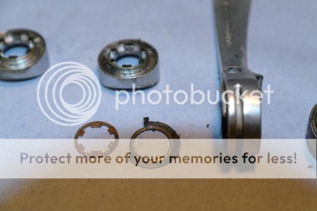

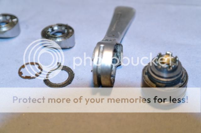

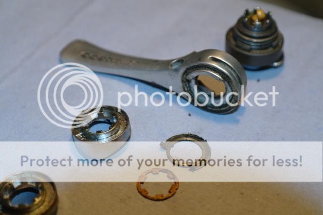

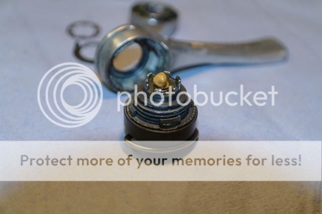

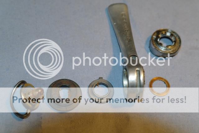

This is all that came off.
Chrome dt fitting.
Brass cut out washer
Metal washer with prongs
Lever
Index unit
Screw
This is the left lever for reference.
HTH
