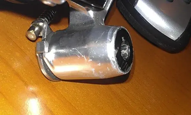

Rather than clutter the forum with new threads, I thought I would recycle this one.
Do I have any parts missing from the Mavic mech shown in the picture? I know HOW the damn thing is supposed to attach to the frame but damned if I can work out how to make it happen. What I call the angle of dangle stop screw just won't go into the correct position. Are there any parts missing?
Thanks.
Thanks.
No parts missing, I have same mech. Ensure the retaining bolt (middle left piece on photo) is butted up to the stop on the top piece of the derailleur (where the frame securing bolt goes). Said retaining bolt then buts up against the stop on your frame gear hanger.
Hope this makes sense, if not I can photo mine attached to a frame...

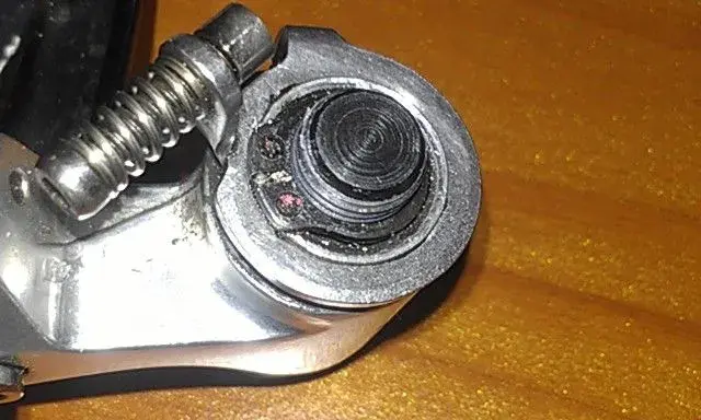

PostPosted: Mon Jan 07, 2013 9:20 pm
Joined: Tue Oct 16, 2012 4:16 pm
Posts: 1568
Location: NOTTINGHAM
actually ( :oops: ) there may be a small retaining clasp missing that holds the main frame bolt and retaining bolt to the derailleur.
See pic of said clip and where the various sections line up so the derailleur holds under chain and cable tension.
