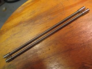

I pondered whether to ask here or at my LBS and here won! Probably a stupid question (why i pondered) - the cable outer that runs from the chainstay to the rear mech on my Rapide is metal with no covering. It is in good condition and needs a clean.
Can these outers be bought? Do they differ from plastic coated outers?

I don't think there's much difference between the older metal outers and more modern ones, especially if you're using downtube shifters. more modern ones might have better coating inside that reduce friction, which helps with STI/ergo levers. The metal ones might be hard to find now though. If yours is in good condition then why not just reuse it - flush it with GT85 or similar and it should be OK to use. Otherwise you can just use normal gear outer, no problem at all.

I've got afew of those things in my bits box...Campag I think.
PM if you fancy one.

Modern outer cables are builded otherwise. More to the exact use of it. The treads are in length instead of rounded up by cirkels so to speak as the old ones were. You need even a special kind of tool to cut them to the right size. This difference is because of the more precise type of indexing refering to the non-indexed way of the past.
