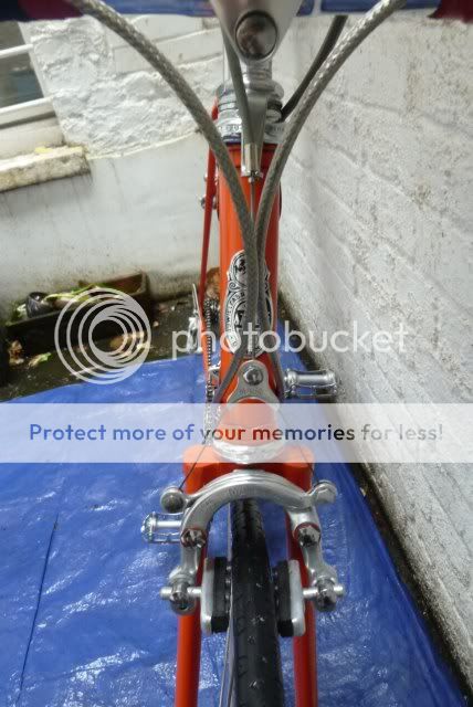

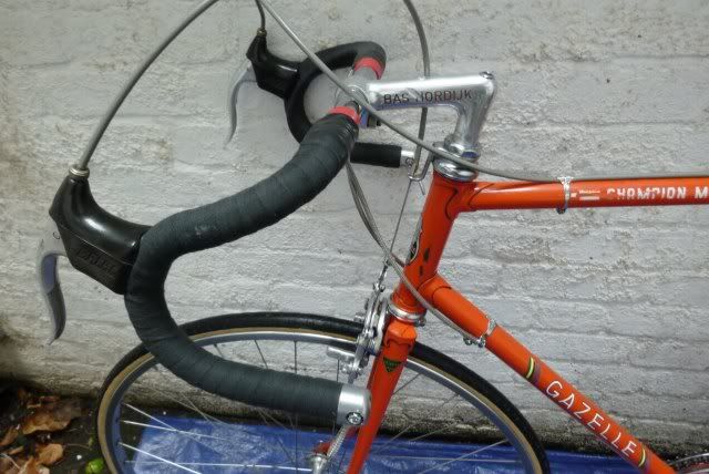

I've got some old campagnolo bar end shifters
Just installed them but not having much luck making them work properly
The cables seems really stiff and both front and rear mech won't spring back when I shift the levers
I used jagwire cables, the coating on them seems pretty shit, most of it came off when installing them
For the routing I just copied it from some previous pics of my bike, This is how it was done when the previous owner had it

If the mechs won't return on their spring (and they do work normally under their own tension) and you are sure that the cables are good then it's the cable routing. To be honest, to keep the bar end shifters in the same style as the bike, you need to let the cables exit correctly and let the cables route to the cable stops as they should.
You may be able to get this current setup to work if you used longer lengths of outer cable. That's based on your second pic, as the cable seems to have a sharp angle as it exits the bar tape near the stem to move down to the cable stops, if you used longer outer then your outer wouldn't have a what looks like a sharp bend :)

With bar-ends it's often better to have the cable outers exit the bar tape at the 7 o'clock position on the hooks, and then flat to the frame stops.
To slacken the curves (a originalshinkicker sensibly advises) you could also fit the cables to the opposite sides on the stops (front right, rear left). Then cross the cables under the down tube.

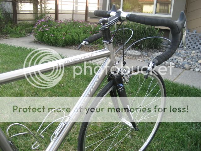

Bar ends cables always exit the bar tape as per lower picture in my experience from the world of touring bikes. Never seen them remain under the cork tape all the way to the top. The more corners you need to curve around the greater the static friction.
