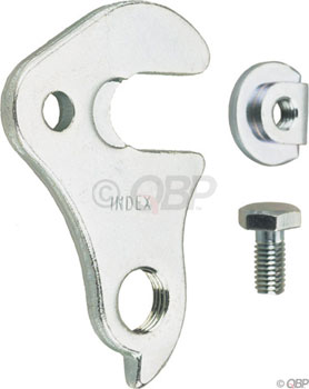

http://farm3.static.flickr.com/2033/223 ... b6ab_o.jpg
http://d3d71ba2asa5oz.cloudfront.net/32 ... dp1071.jpg
should look like the top picture, you should have a nut and bolt that secures it like the lower pic :)

Just had a look and im confused as to where this bolt is supposed to locate in the frame on the dropout.. theres nothing for it to slot into on the dropout?

I'd listen to old Ned/Shaun before me.
I only had one bike with a separate gear hanger, perhaps mine was a bodge and a hole had been drilled in the dropout in lieu of the proper set-up, as seen in Shaun's photos.
EDIT
Our posts crossed: that confirms it, you need the special bolt as suggested by Shaun.

ScillySuffolk wrote:
I'd listen to Shaun before me.
EDIT
any idea where i can get one?

looking at the reverse side of this made it clear to me. Would be hugely appreciated if you have the correct nut and bolt going spare :)
