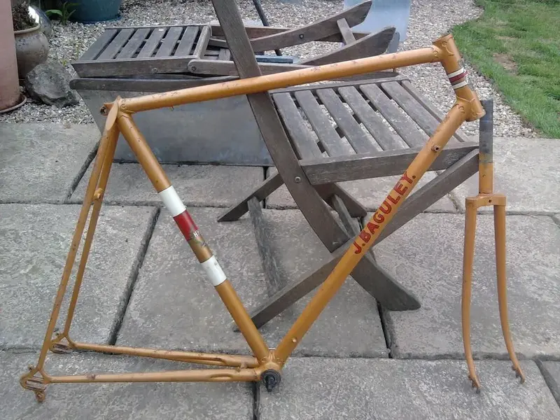

I've been using this frame with a 6 speed block on down tube changers. The LBS says 'depends on the spacing on the bottom bracket, but shimano sora and tiagra fit pritty much all frames'

Cracking frame..........needs more period stuff IMHO. Nothing expensive like Campag.
Shaun

That does look nice!
It's better to have a bike on the road with non-period kit than off, but you'll have less hassle fitting period components.
With a little patience it needn't be costly if, like Shaun says, you avoid the premium stuff.
Modern Shimano is pretty ugly too: like fitting alloys and a bodykit on an E-Type!

That's an absolutely cracking period frame. I'm seeing Chater Lea, Airlite etc. Worth the hunt and cost as you're starting with something so good.
