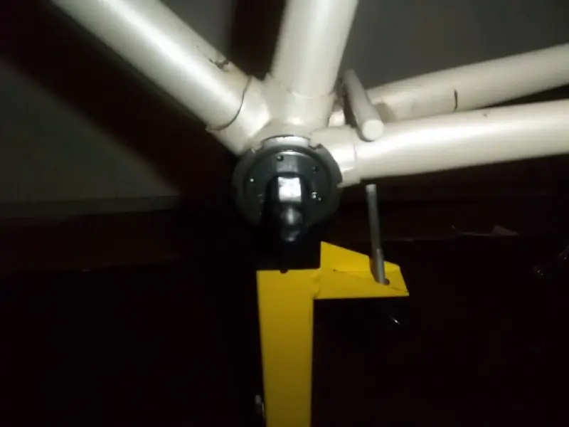

Right, he goes with a pic - fingers crossed (again).

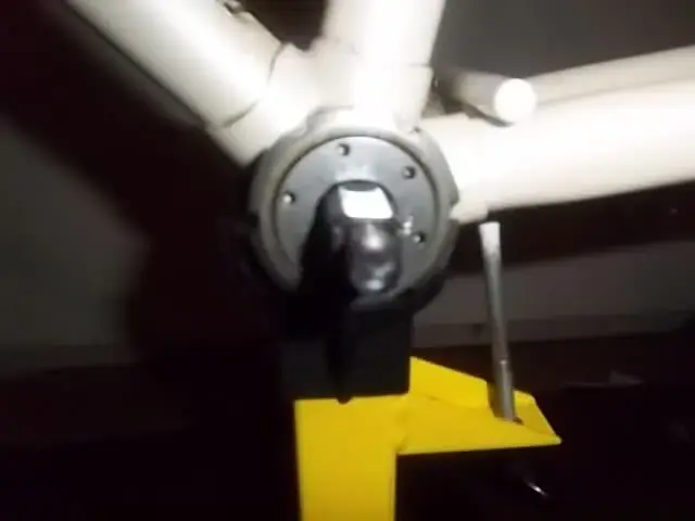

And another

these:-
for the fixed cup on the drive side
http://www.parktool.com/product/crank-a ... ench-hcw-4
for the adjustable cup
http://www.parktool.com/product/adjusta ... nner-spa-6
for the lock ring
http://www.parktool.com/product/crank-a ... ench-hcw-5
other tool brands are available! :D
