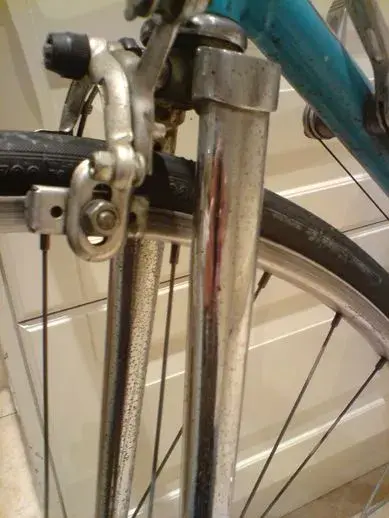

BBC Tom wrote:
I have added the other pics I took of the bike to my photostream - http://www.flickr.com/photos/66316617@N03/
That looks almost as good as new to me :)
Best thing I find for removing rust speckles from the chrome is some good quality 0000 grade steel wool dipped in engine oil. You'll be amazed how well they will clean up. Some pics below, but this was only minor rust speckles, I've cleaned up far worse but didn't take pics :?
Same goes for the paintwork, WD40 will remove any tar or oil stains plus general crap, anything stubborn or rust staining will come off with the steel wool and oil. Then a good T.Cut and wax.
Toothbrush and WD40 for the derailleur and small parts then Autoglym for polishing all the alloy. You can strip the calipers and alloy parts and buff them with a mop on a drill if you want them like a mirror.
New chain, new gear and brake cables plus your tyres and all should be perfect. Oh and a bottle of champagne to christen it :P

Thanks for the reply. Unfortunately the chrome on the wheels has pitted and flaked, the paintwork has flaked and rusted and the tyres have perished. Some pics of my hornet (motorbike) are in that album too and I have done all of the work on that myself - I just know these news rechroming. I could get the bits powdercoated up, but my fiance loves the classic look, so I don't want to spoil that.

You can use kitchen aluminium foil + water to remove rust from chromed parts. I cleaned terrible rusted rims on my bike. I spend few hours on cleaning but it was worth it. After just swipe with oiled piece of cloth. I used wheels cleaned this way for about year on daily commuting (even during rainy days) and rust didn't reappear.
Rechroming is expensive and only reasonable if the part is valuable. I think it's better to find replacement or here on forum, or jumbles, or ebay.
About the tires for 26x1 1/4 (old EA1 standard) you can find them on ebay. There is veeeery slight chance that you find them in bike shop (In my LBS they had them buried somwhere deeply). There are Kenda and Raleigh of this size. I'm using Kenda with amber walls. You can also find tubes Continental or Schwalbe.
