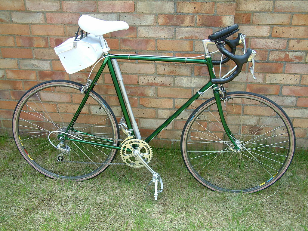

My 1959 Carlton is 130mm. Not sure when it was done but it's been fine in my hands since accquired 6-7 yrs ago

I think the actual measured OLN is 128.7mm but as per the pic below it's fitted with 8 speed DA wheels so 130mm and they slotted straight in no problem. I've changed it back to a 6 speed friction shift set up and added a small spacer to the axle
