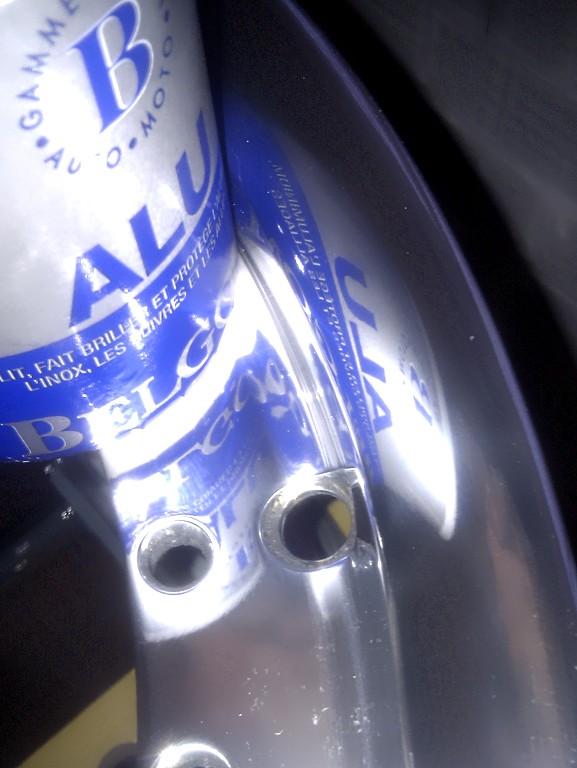

I polished these rims with a proper polishing kit from 'The Polishing Shop'
And then finished with Belgom Alu...
BBS RC040 Refurb Belgom Alu by outHOUSEpics, on Flickr
Autosol for anything stainless steel - But note Autosol or anything like that is too harsh for aluminium to keep a mirror finish.
