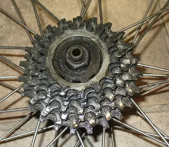

Cassette is definitely Uniglide, first one I have seen, my 1990 Raleigh Mirage MTB has the HG cassette.

Oh yeah thats UG for sure. Hard to find which in turn can redue the amount you can get for them (harder to get spares for, although perfectly servicable and easily changed to HG).
Yes your mech will cover 8 speed.
Fit a Campag crank and brakes and you'll be all Campag then. What have you got your eye on on eBay? Or would you rather not say?
