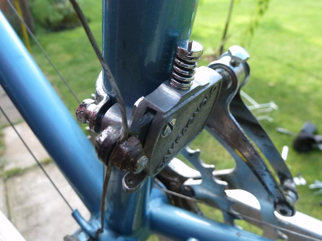

Does anybody have any knowledge information on this front Campagnolo mech?
Thanks
Neil

http://velobase.com/ViewComponent.aspx? ... &AbsPos=18
Variant of the 50's Gran Sport Pushrod
Didn't see many even in the 70's when I worked with bikes.........

That's a Campagnono Valentino/Gran Sport 1005/2050 front from early 50s- mid 70s...
Some other catalogue scans here at Campyonly and here at Retrobike

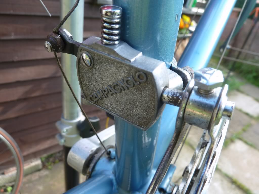

Also known as the "matchbox" :wink:

There is a big difference between the Valentino and the Gran Sport when it comes to collectibility. This is the much more desirable Gran Sport model from the 50's.

What is the difference between the Valentino and the Gran Sport?

The Gran Sport has the cage securing bolt on top at 12 o'clock, the Valentino has the bolt at the front at 3 o'clock :)

The Valentino was introduced to compete with the lower grade imported derailleurs. Apparently named after Campagnolo's son.
Didn't do very well.
Follow the link for all you need to know
http://www.disraeligears.co.uk/Site/Cam ... lleur.html

As well as the '3 o'clock' cage screw the Valentino also has a 'boss' moulded into the body at the point where the arm exits.
http://velobase.com/ViewComponent.aspx? ... &AbsPos=12
This is a good example of the genuine early Gran Sport and, as such, should be passed on to me to go with my Gran Sport rear mech :wink:
