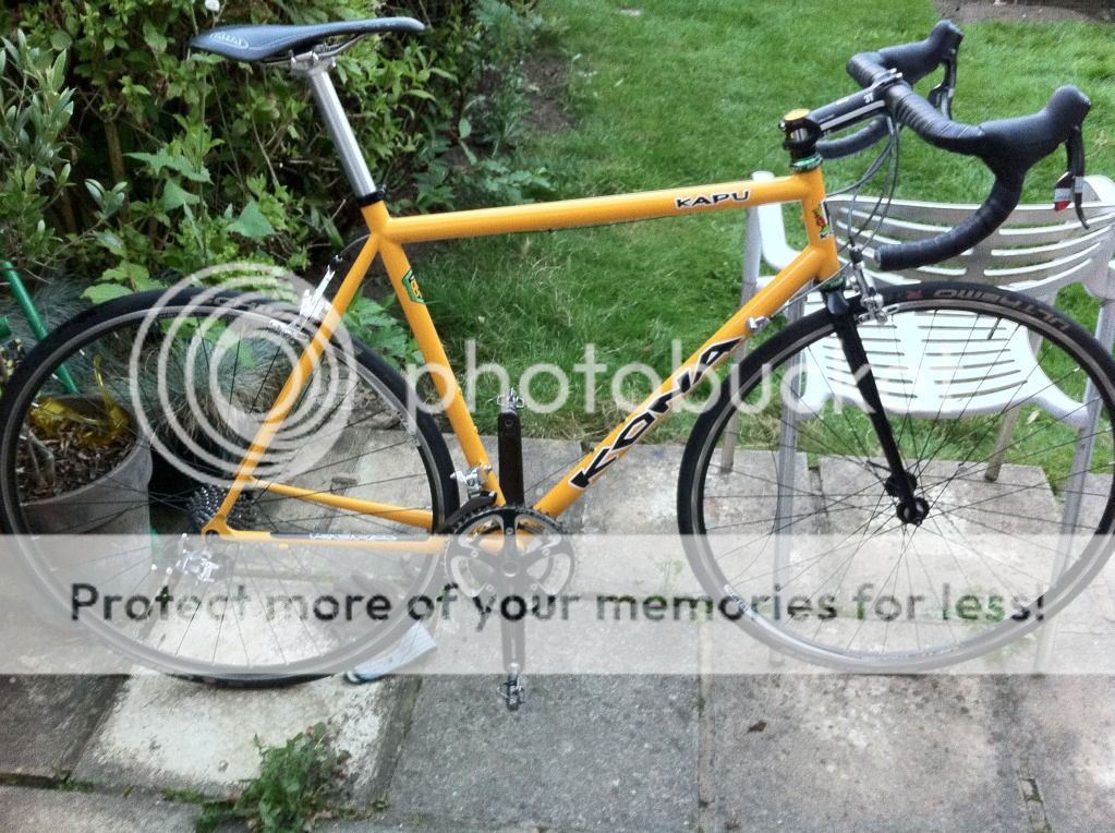

Guys, i've never tried fitting modern 10sp on to older frames before - but I think this frame wears it well.
Im yet to fit chain and cables and dial it all in. Is there any reason that the 10sp system wont fit?
Any chain line issues to worry about?
In my mind it'll work, but i've been wrong before.

From my very limited road bike experience, but extensive mtb experience, if the OLD will take the 130mm hub (which obviously it will) then you should be OK.
There are however a couple of things to watch:
You will find that chain angle gets a little steep at the extremes of both front rings, but by the time it happens, you should really have already changed gear at the front anyway.
You may also find that in the lowest gear on the inner ring you may find that the top jockey wheel or even the rear mech itself will contact the cassette. This can usually be corrected with the B adjust screw on the mech.

Thanks, ill keep an eye out for extreme angles. Would be so nice to be able to set it up without issue

If it helps your confidence, I have a 10 speed SRAM X9 set up, including twist shifters, on my 1990 Roberts White Spider, and all I needed to do was tweak the B screw a half a turn, as the jockey wheel was touching the cassette. After that, I did 30K off road in the Forest of Dean.
