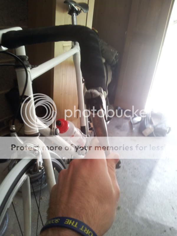

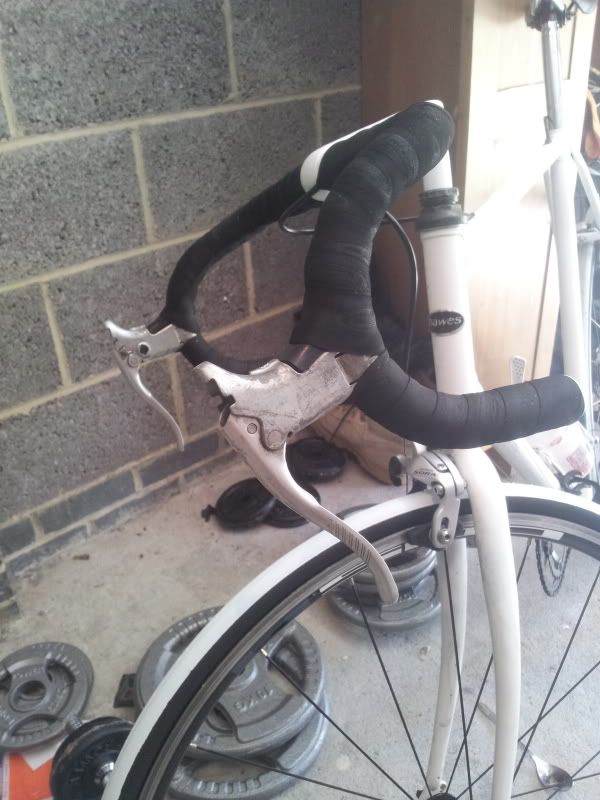

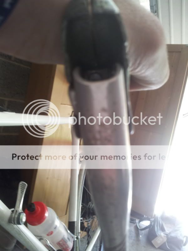

PostPosted: Tue Sep 04, 2012 12:47 pm
Joined: Sun Aug 05, 2012 8:55 pm
Posts: 13
Cheers bud, Ive taken a few pictures for ya. Excuse the mess ;) - Garage is in clip atm!!
The brake levers say "Exage" on them, which isnt highlighted in the pics as its blurry..
