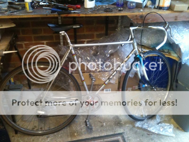

Hi Guys,
Just been stripping an old Alan cross frame I've had knocking around for years as I fancy having a go at turning it into a fixie..... :D
It's pretty much all there but never having built a fixie before I'm kinda lost about now......
It's a bit of a lash up.... it's a 54x54 frame but is wearing a set of old Olma forks, I stuck a set of Cinelli bars, vintage stem and a pair of Weinmann levers on this afternoon as well as stripping the gear related cabling out....
My main issue is real wheel and chain line.... at the moment is got a 7 speed block on as I had it set up as a hybrid and a Middleburn double chainset.
Not sure about ratios etc and whether to change the chainset for a more suitable single ring job, also can you buy rear wheels with hubs off the shelf ready to go etc ?
Any help appreciated....
Cheers
Paul

For a fixed wheel you need a proper fixed wheel hub, two opposing threads (sprocket and lockring) otherwise the thing unscrews on back pedal pressure. Loads of people on here might have one knockiong around :)
Best chainline is usually the inside of the double :)
Finally, if you are not used to a fixed I'd cable up the rear brake...
Cheers
Shaun

Please replace the forks, or spray them silver, get some chrome, anything but those!!! :shock:
I fully agree on that. An ALAN with a steel fork..... tssss. :wink:
And also..... the frame is a cross version, see the rear brake, with a road fork....

Hi Paul, i ride Fixie a lot on the road as it is good fun and good training, i have even ridden fixie on the North Downs - made it a bit exciting! Your Alan will be a good bike for a Fixie - i remember them in the 70's when they were new !
You can get single chain rings to convert Shimano or Campag road chainsets to single speed use - with the proper spacing and chain line - i recommend - www.velosolo.co.uk for chainrings and all other stuff you may need. Their bolt on cog conversions are good also - i did my own on a Hope pro 2 front hub. Plenty of track wheels / hubs etc on Ebay. I ride 46 chainring x 17 sprocket for 73'' gearing which is good for the area i ride - i can get up most small inclines but it is a struggle up a big hill ! you can then ride a steady 17 / 18 mph average and spin madly downhill. i can keep up with my road bike pals on all but the fastest flat parts when they wind up a big gear. Happy to help if you need any more advice - happy spinning ! Mark
